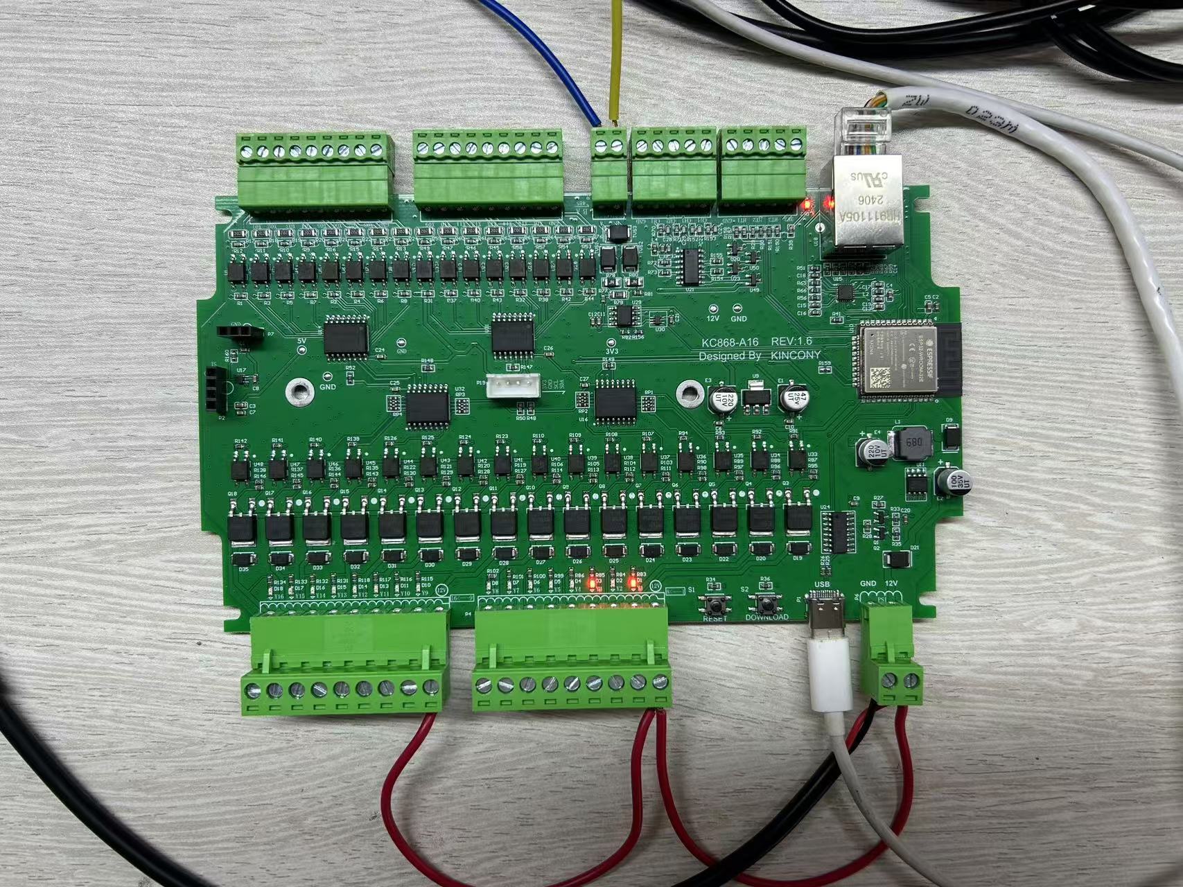

KC868-A16 is P mos output, when turn on, it will output 12v or 24v. see this photo, maybe you have not connect with RED cable with "DC" terminal.
