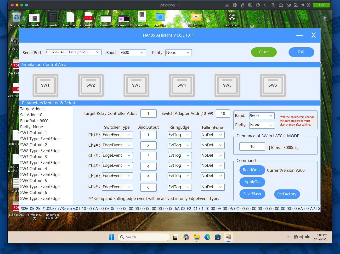

Hello!
How to control the D1 to D6 output pins using the PC TOOL? I have everything connected like this: ![]() I can see the PC TOOL changing when I connect K1 to GND, but I can't get my LEDs to turn on using the PC tool
Yesterday, 11:15 PM
which PC tool? take a photo of screen.
Today, 12:09 AM
This tool
Today, 12:37 AM
PC tool just use for config.
the Dx LED need feedback from kincony's relay controller message for LED ON/OFF.
