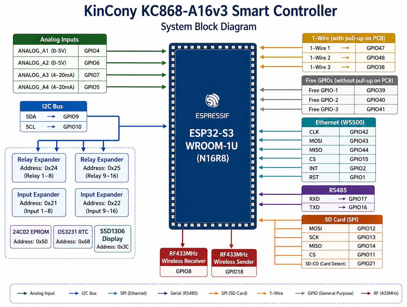

Just a small remark: on the board's system block diagram, the EEPROM is listed at 0x60, but it is actually 0x50 on mine according to the I2C scan at boot. Anyway no issue at all with this for me.
[Image: KinCony-KC868-A16v3-smart-controller-dia...ix1000.jpg]
Have a nice day!
thanks for feedback. we have updated.
