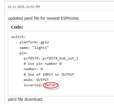

Sorry no this is your latest code from website i believe,  and for the kc868-a16 rev1.6 this needs to be changed to TRUE - i also noticed an image someone else put on showing they had changed them to true as well.  It needs to be done for inputs and outputs just so you are aware
