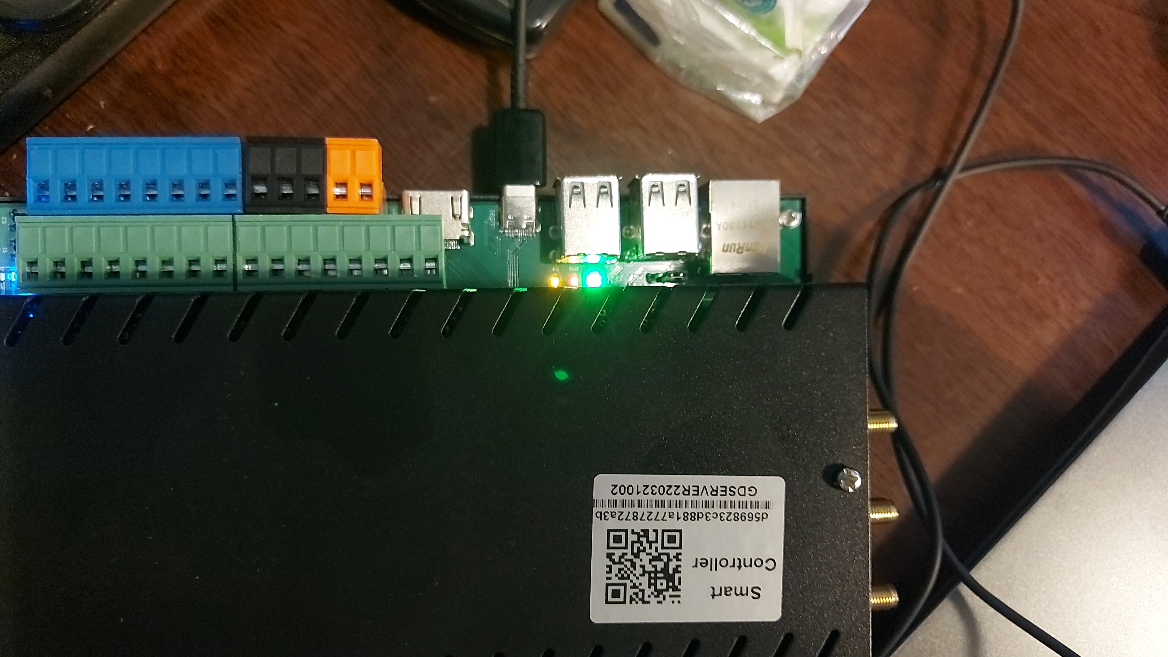

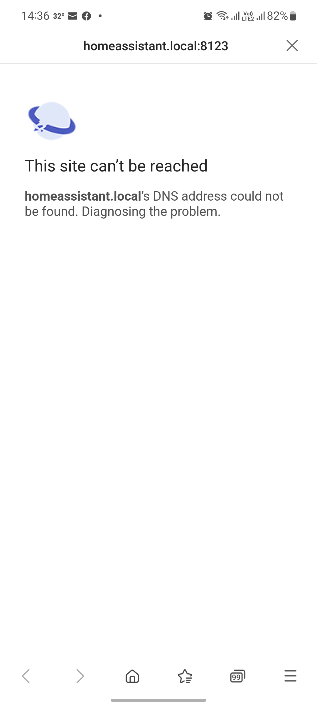

I waIted long time not 3 min and the home adistance didn't come up
Also
http://homeassistant.local:8123/
Is not working see attached photo
My laptop is crsshing blue screen many times and restart it!!!¡
I didn't connect any usb when installing the system of itching ?
Also i can't see the rasperry pi ip  ?
What shall i do now?

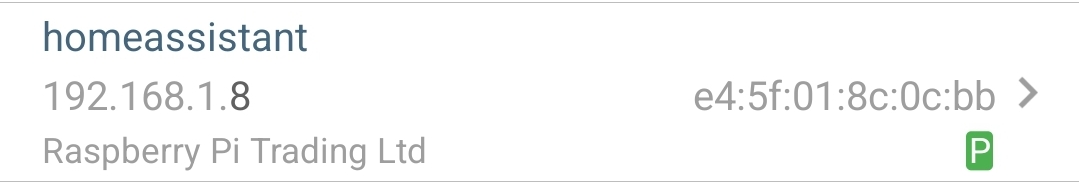

- if you still can't see homeassistance on ip advanced scan, just reset the button S2 of the server ( Ethernet rest )
then will appear homeasistant and ip see attached for this example: http://homeasistsance:8123 or http://192.168.1.8:8123
