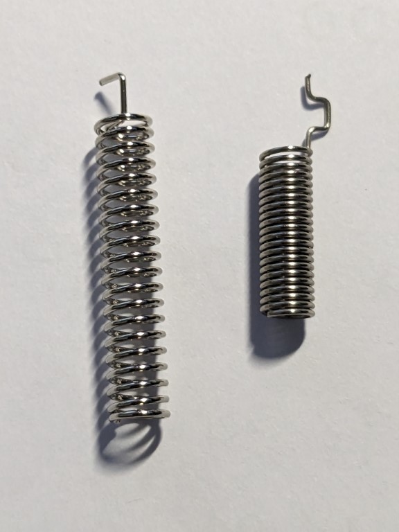

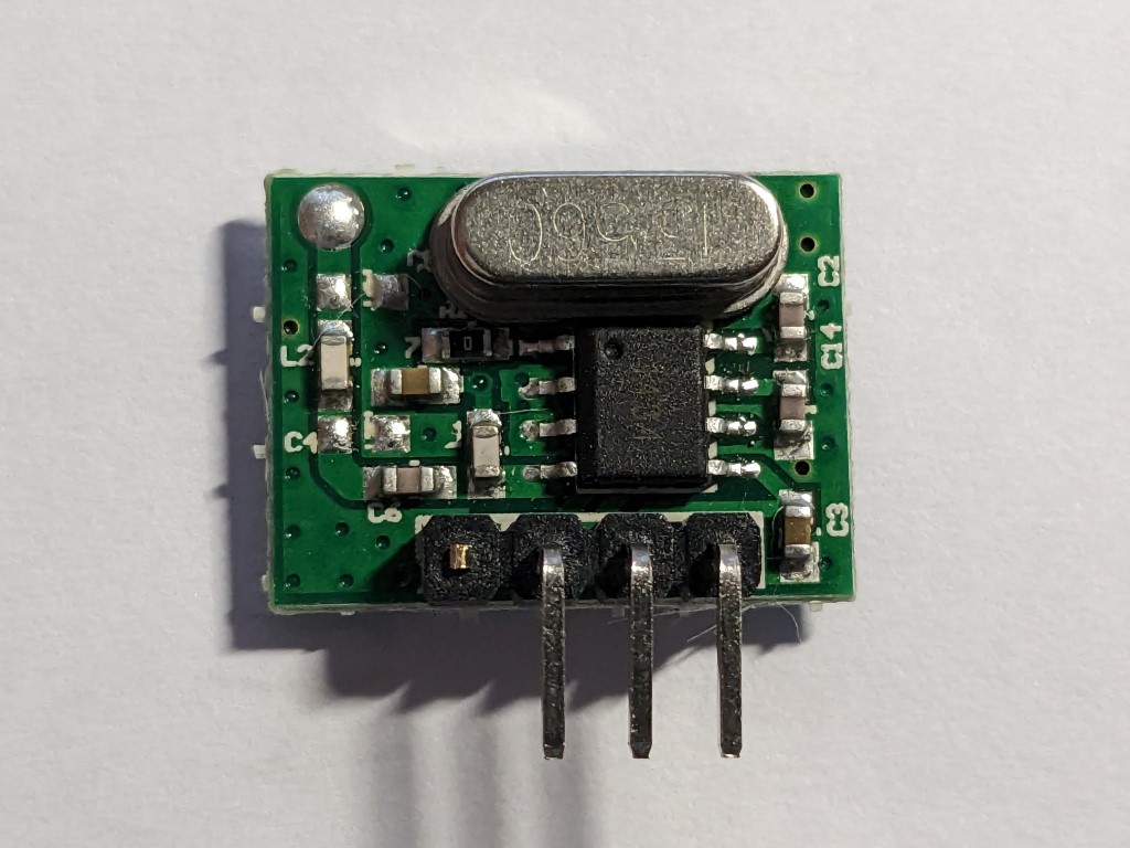

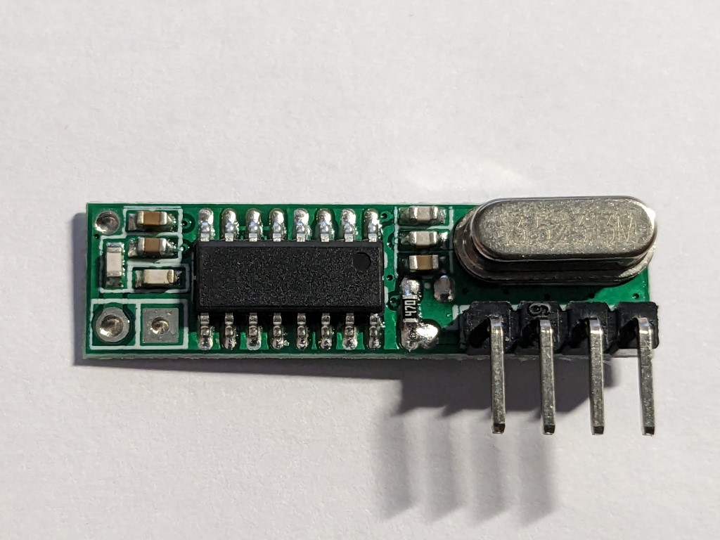

I have finally received my KC868-A16 including RF.
Where to solder on the antenna and which to use in which module
