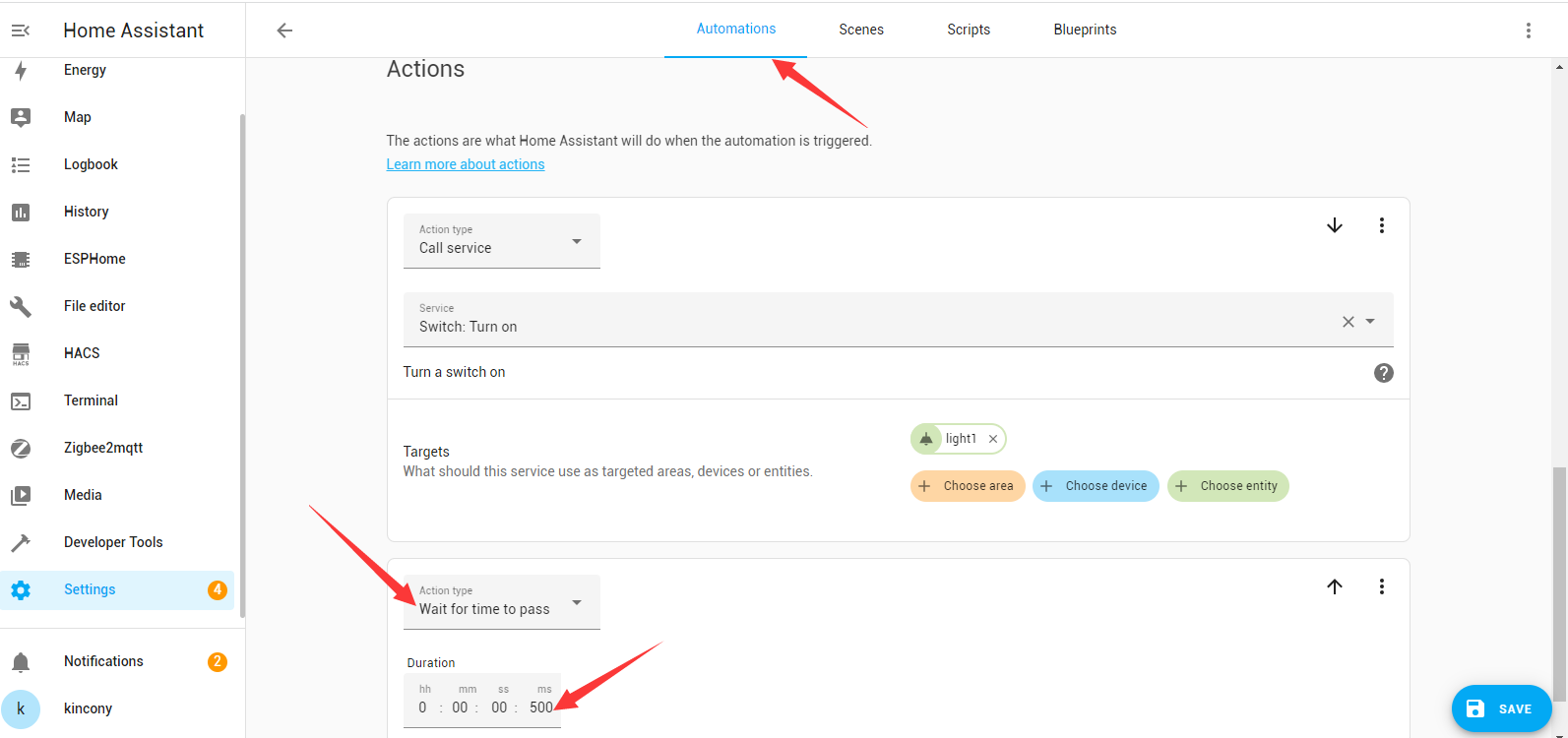

set in automation: relayX ON -> delay 500ms -> relayX OFF

I tried to do this I did exactly what you asked me to. But its not allowing me to save. I am getting the following error message,
Message malformed: Integration '' not found
Will you be able to login to my computer please?
I got both Any Desk & Team Viewer

what your "trigger" for the action: relayX ON -> delay 500ms -> relayX OFF
such as input1 is trgger THEN relayX ON -> delay 500ms -> relayX OFF.
what do you want to do?
Posts: 20
Threads: 2
Joined: Apr 2022
It works. Thank you. really appreciate your after sales technical support. Now everything works fine.
