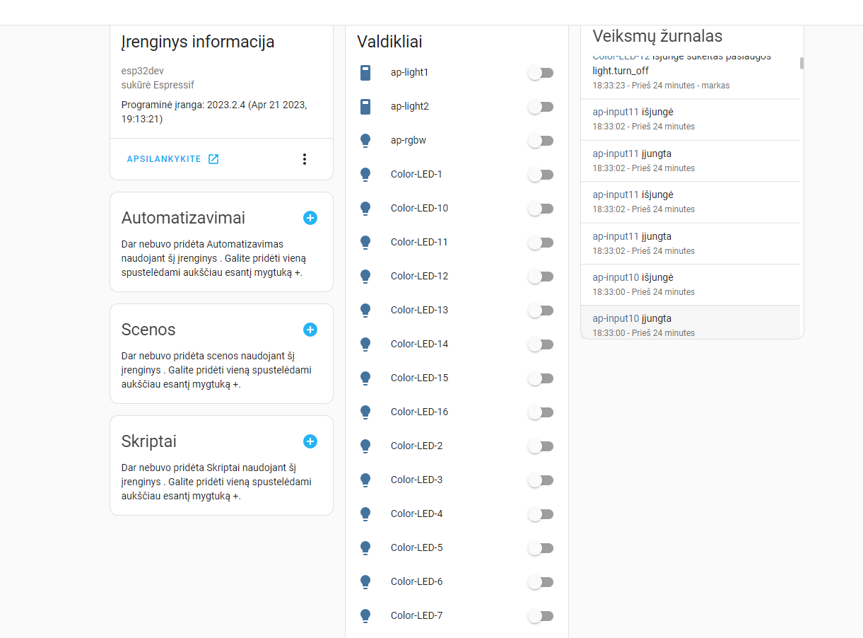

Hello, I wrote esp32 and started the board with home assistant, but the input switches do not work for me. After that, I need all input 16 channels to work separately and I do not promise to control the rgbw band. It's just that I have 16 individual dimmer switches in groups that need 1-10v control and to work with switches. Maybe you can edit the program to work and upload the corrected file
.txt   kc868-ap.txt (Size: 5.98 KB / Downloads: 453)
digital input can't use?
your LOG photo, there is error of PCF8574, maybe have set wrong address, please check.
