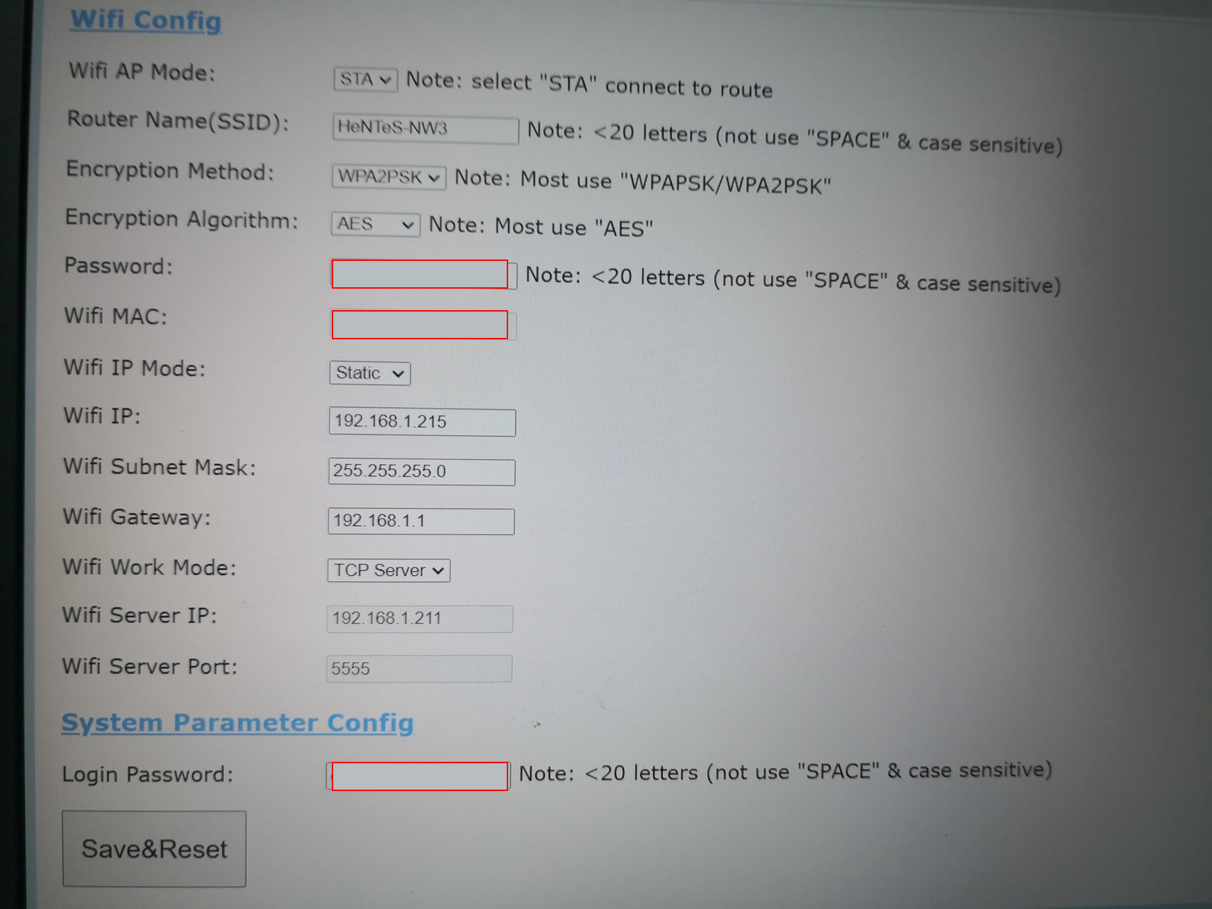

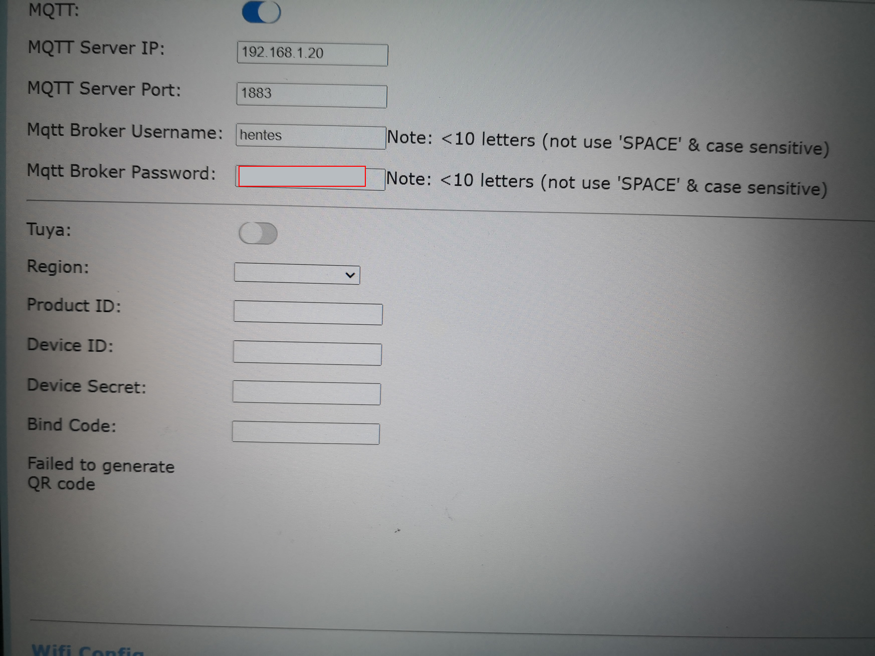

So I downloaded version 2.7 again and the same situation happened. No modbus and no mqtt data is sent. Cannot read modbus data even with Kincony Smart Board Controller. In MQTT Explorer no mqtt data is received even when short DI with GND, mqtt no feedback. I have attached some photos from all the configuration.

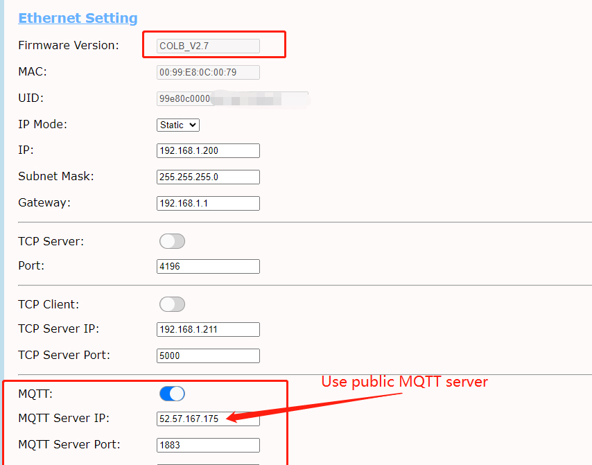

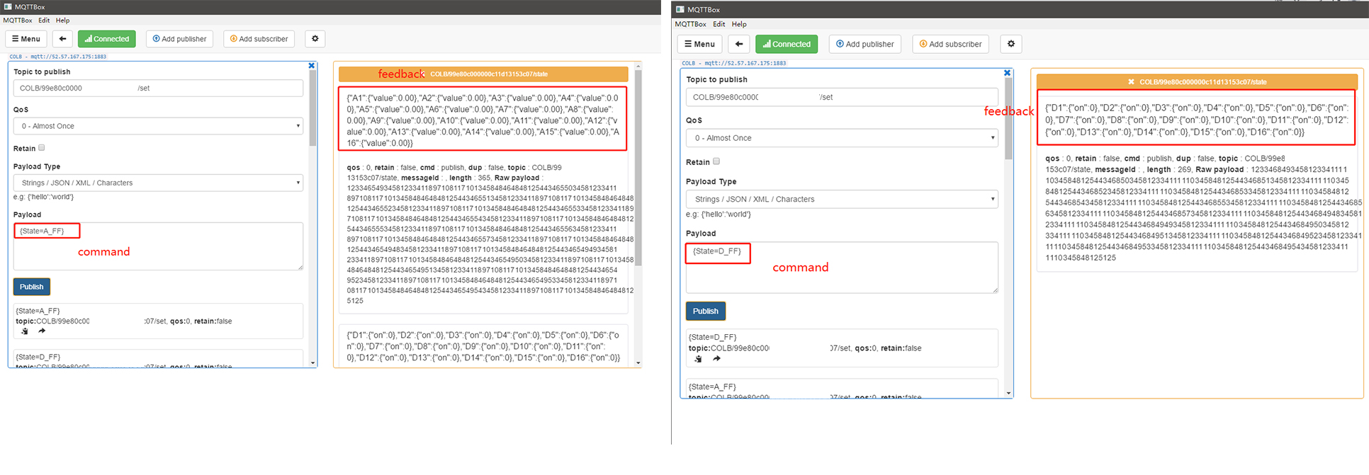

my COLB is update to firmware V2.7  and  i use the public MQTT server i can receive the message .look at the photo.

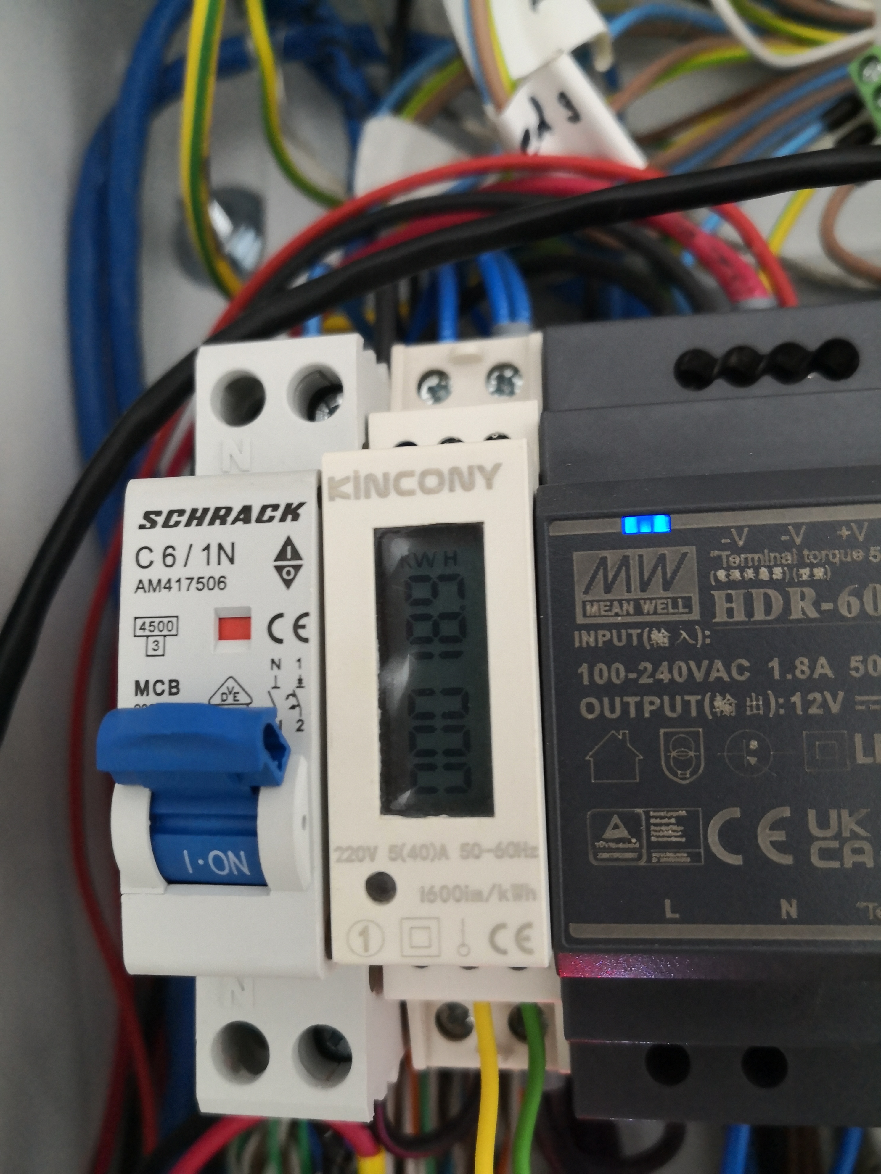

The modbus is used to collect data from Kincony power meter. No other device is connected to modbus.
