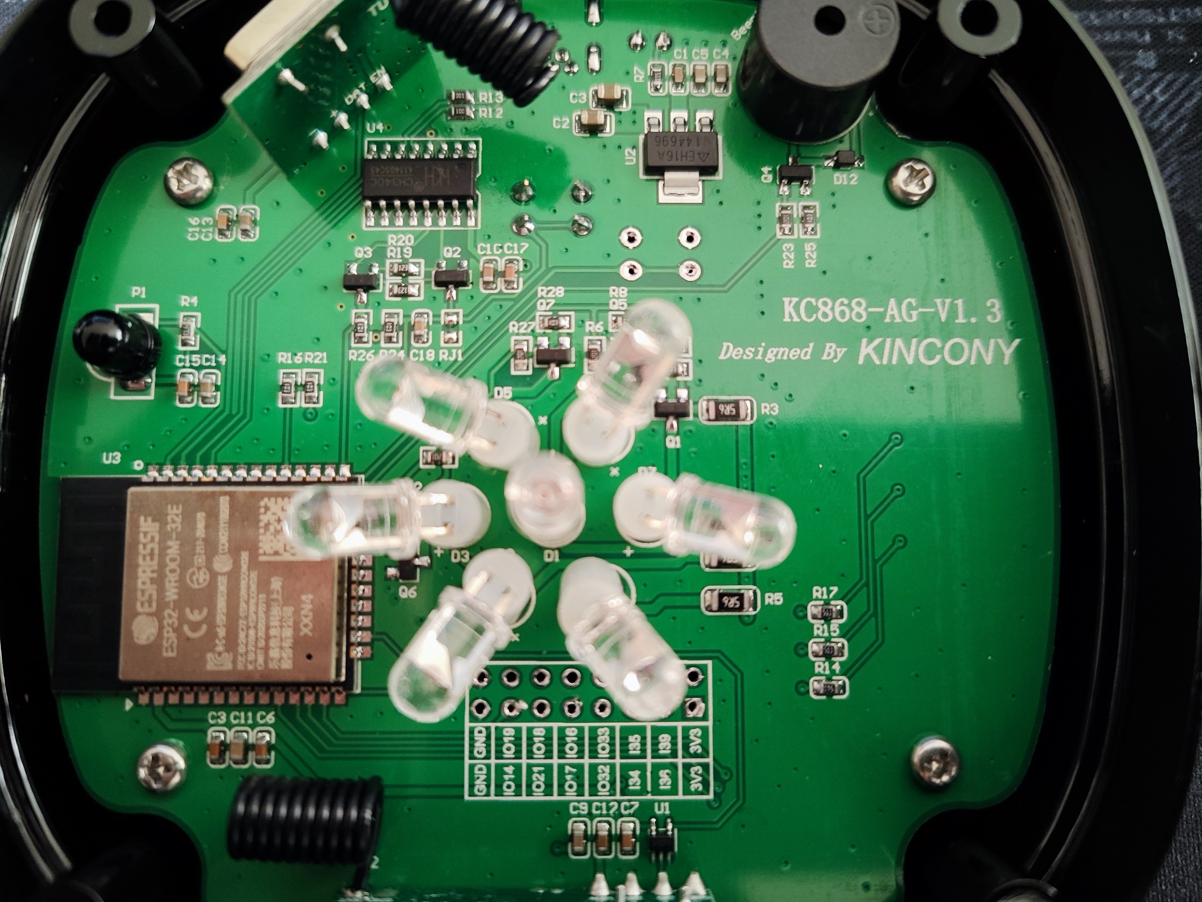

Since it does not work I decided to open it.
RJ1 is not populated. Is it expected?
open the box, take a photo.
Here it is (Note: I did change the position of the antennas):
RJ1 not need use, NC
