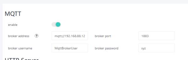

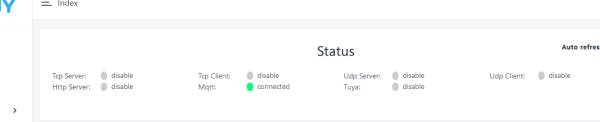

I have an A16 board, it has firmware KCS_KC868_A16_V2.2.2.bin and I would like to set up communication with Home Assistant (HA).
In A16 I set the values for HA in Protocol > General > MQTT (see image). Mqtt communication can be seen in green in the Monitor.

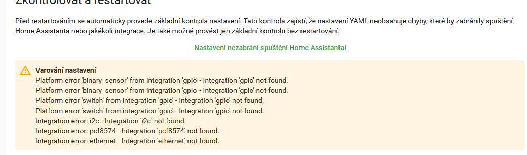

If I use the code for ESPHome from https://www.kincony.com/forum/showthread.php?tid=1628 in the configuration.yaml and change the IP addresses of the devices, errors are reported when checking the configuration before restarting - see image. Please give the whole configuration.yaml file, or a description of the whole procedure, otherwise it still shows errors :o(
post your yaml file at here.
