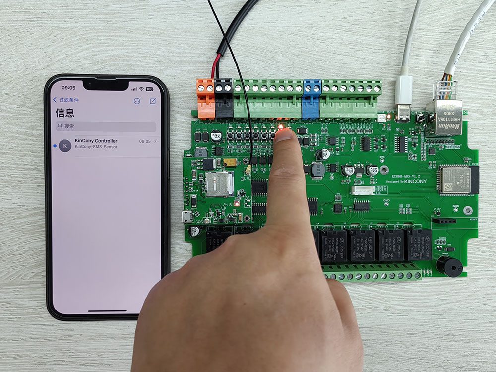

how to use binary sensor send SMS by SIM7600E 4G module in ESPHome
the ESPHome yaml demo made for KinCony KC868-A8S relay board. Actually you can use for any KinCony SIM7600 relay board, just replace 4G module's TXD,RXD define.
here is ESPHome yaml demo:

  - platform: gpio
    name: "Send SMS Button"
    on_press:
      then:
        - uart.write:
            data: "AT+CMGF=1\r\n"  # Set SMS to text mode
        - delay: 1s
        - uart.write:
            data: "AT+CMGS=\"15381188302\"\r\n"  # Replace with the recipient's phone number
        - delay: 1s
        - uart.write:
            data: "KinCony-SMS-Sensor\x1A"  # Send the message "KinCony-SMS-Sensor" and terminate with Ctrl+Z
    pin:
      pcf8574: pcf8574_hub_in_1
      number: 1
      mode: INPUT
      inverted: true
