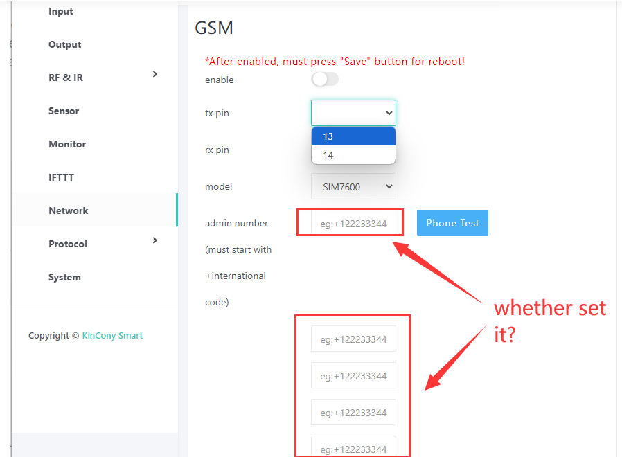

G1 fails to register incoming calls
Do you have set the admin phone number at here? Since the incoming number is not set as the administrator, the call will be rejected.
