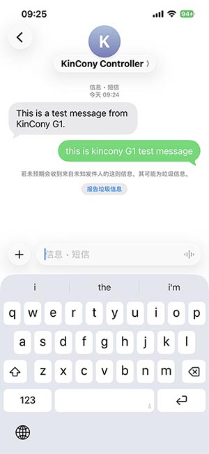

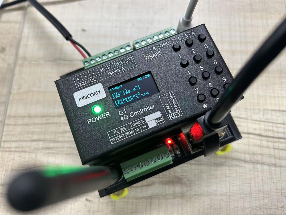

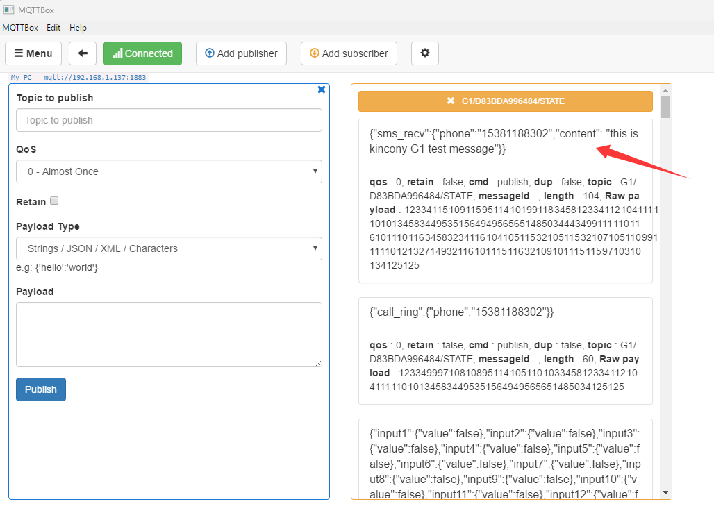

maybe you have not use the admin's phone number to send SMS. here are photo tested with G1:

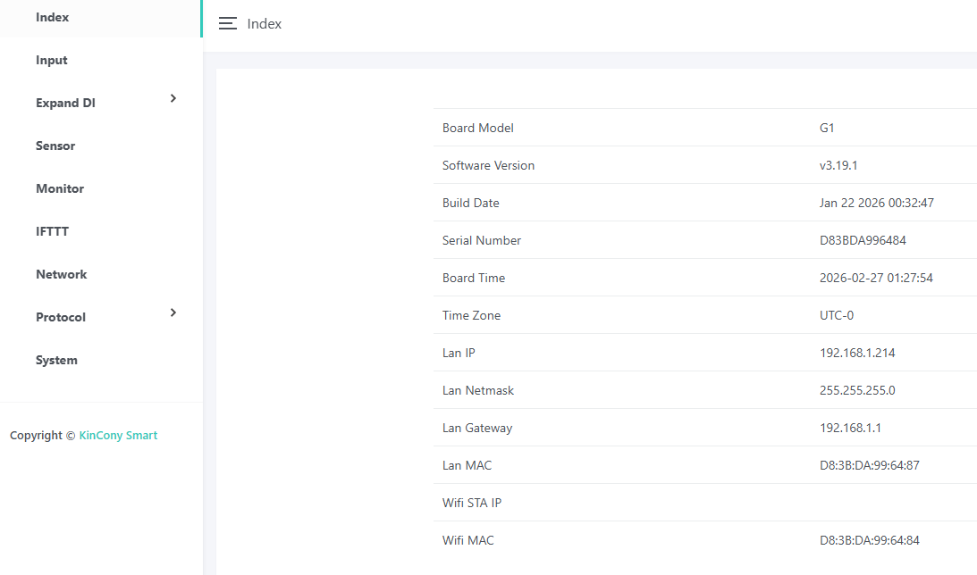

use this KCS v3 firmware to test.

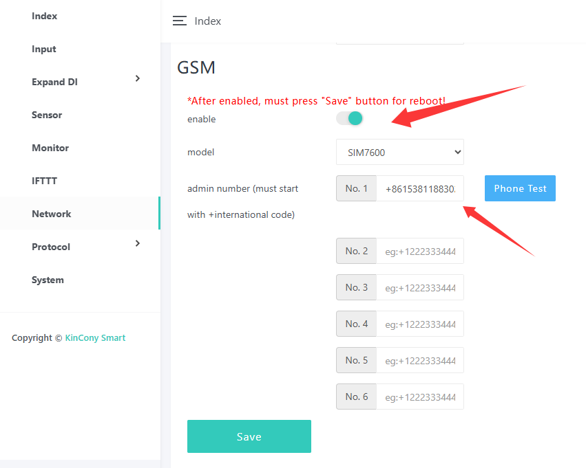

this step is important, must need enable 4G module, set the admin's mobile phone number.
