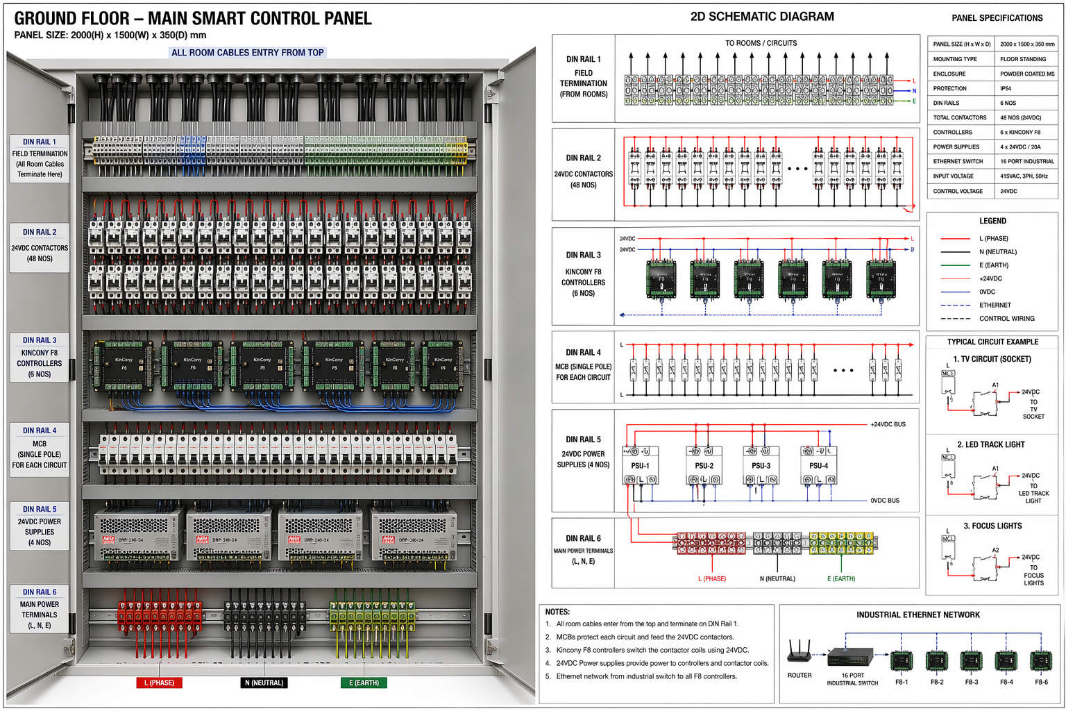

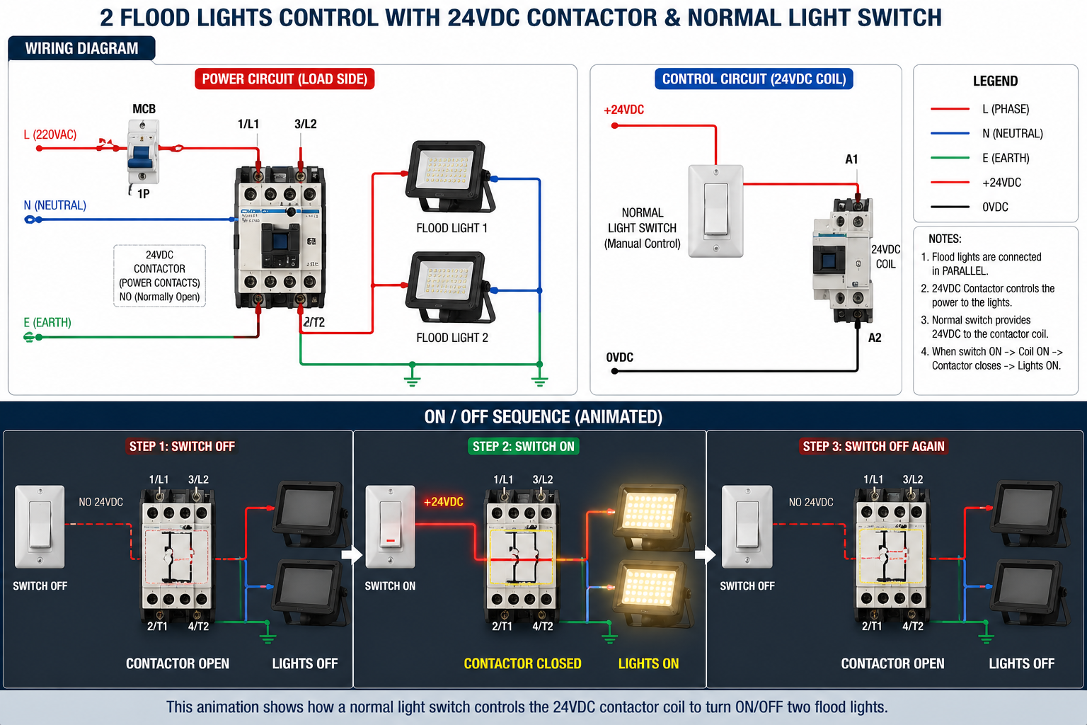

KINCONY IN KSA
This is the Conceptual Image of my new Project in Saudi Arabia, I want to Control Some Lights from Manual Input to Controller, How can I do that
