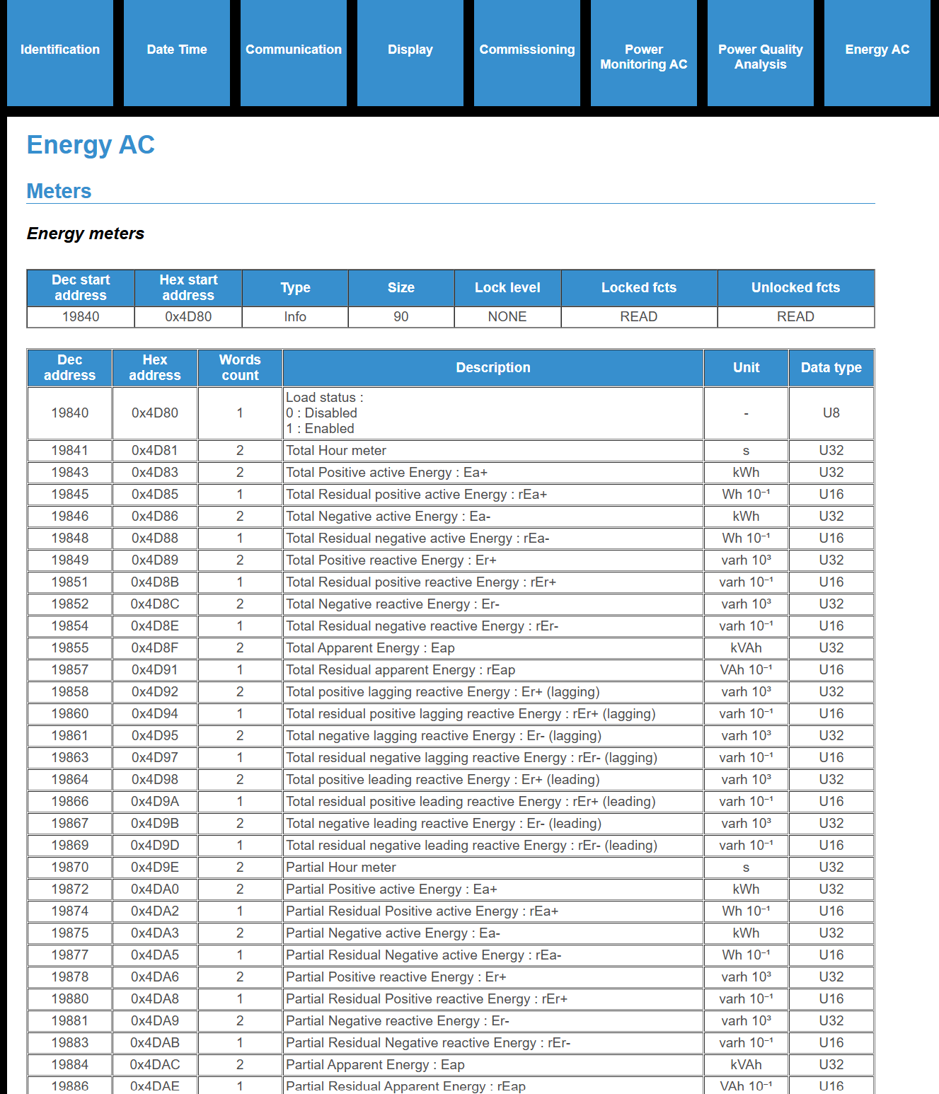

The modbus registers for a device like this:
[URL] https --> www.socomec.fr/sites/default/files/2024-03/DIRIS-A-40-1.7.4_COMMUNICATION-TABLE_2022-01_CMT_EN.html#Energy%20AC
I know these are advanced measuring devices usin in the industry. but the concept is not that different from what the BL0910 does.
If total energy would be splitted into two registers one for + and the other for - it would also allow tot totallize these registers to get the effective energy consumed.
