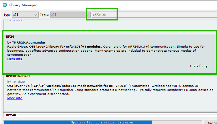

[Arduino IDE demo source code for KC868-A6]--#01-nRF24L01_code
Heart
Receive code
