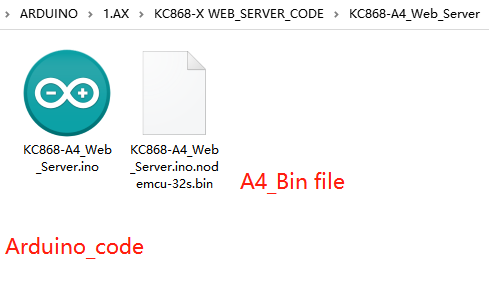

[Arduino demo source code for KC868-A4]-12 web server by wifi
[Arduino IDE demo source code for KC868-A4]--#12-WEB_SERVER_CODE
.zip   KC868-A4_Web_Server.zip (Size: 454.76 KB / Downloads: 748)
* Create Your own WebServer for KC868-A4 Smart Controller*
