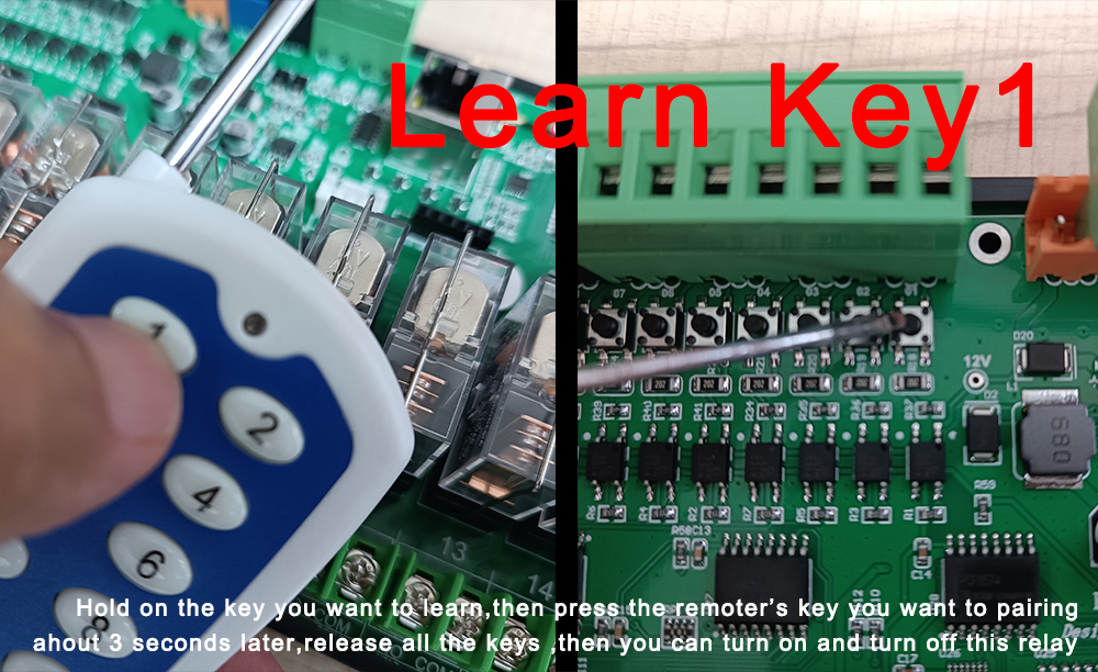

How does KC868-E16T learn wireless signals
Download the following program, you can turn on and turn off the relays by a wireless remoter
