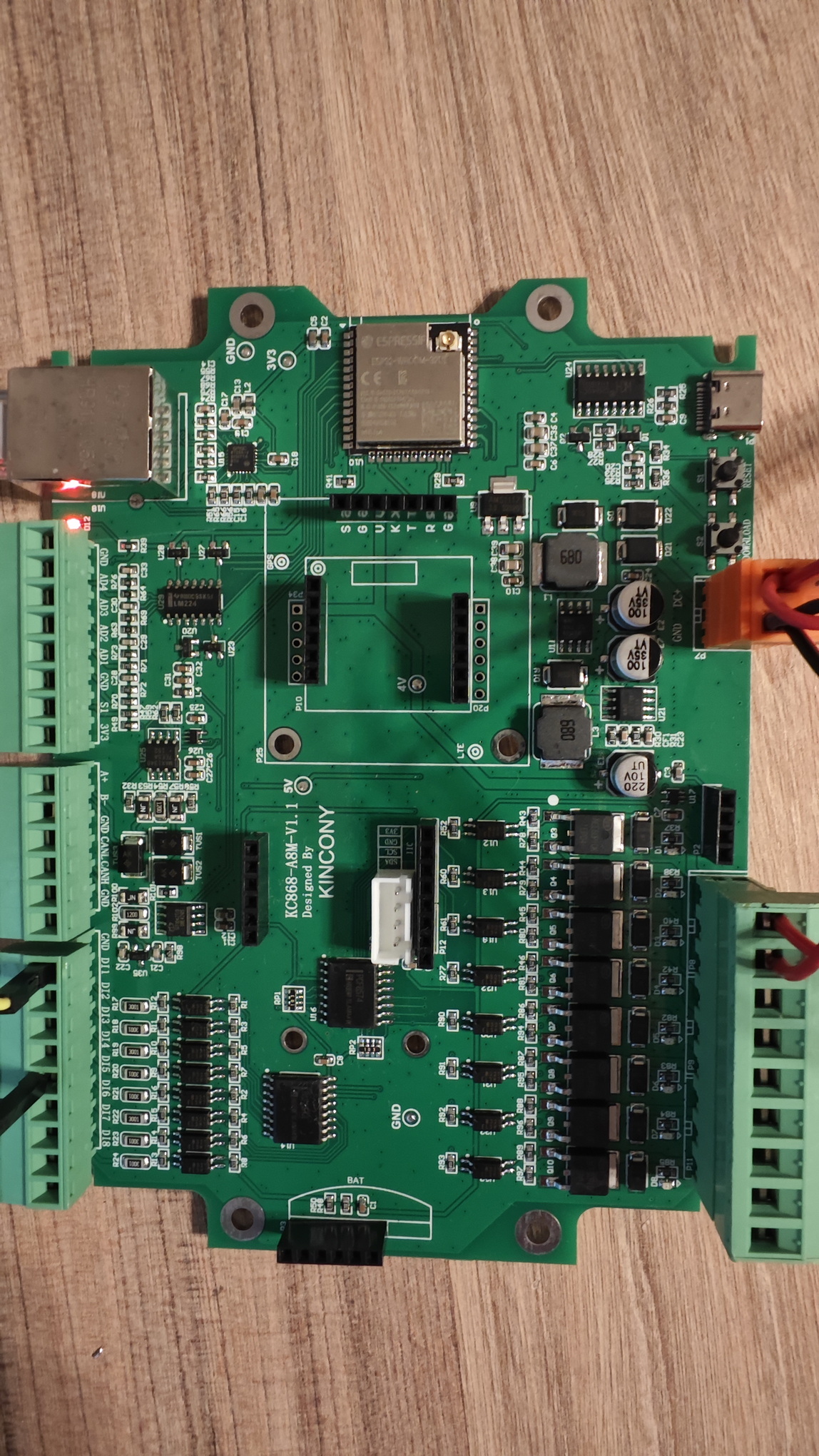

KC868-A8M and PCF857x error
The output is not triggered. By input, the values are either at the first input or at the second in random order. There is no reaction to short circuits
I also have an A16 board - it works without problems
I rechecked the Arduino code
[Arduino source code for KC868-A8M]-05 OUTPUT - the outputs are working, the LEDs are lit up. After applying 12V to the output of the transistor. It turns out that the outputs and inputs do not work only on the KCS firmware. An error in the KCS firmware code?

E (3980) pcf857x: pcf_0 read error!
E (3981) pcf857x: pcf_0 write error!
I (3986) pcf857x: pcf857x init.
