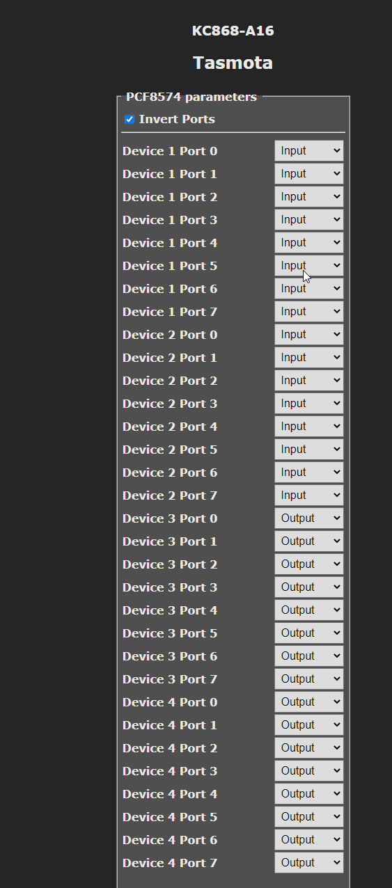

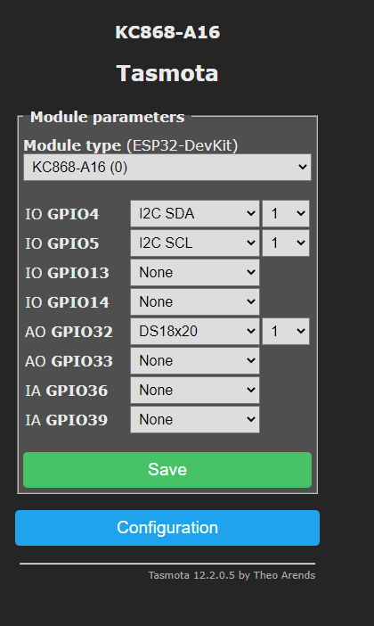

Hi, thank U temperature sensor is working now but PCF8574 digital inputs are not showing up anymore
#12
you need to set "SDA" and "SCL" pin firstly. the follow is KC8698-A6, you just set SDA:GPIO4  SCL: GPIO5 for KC868-A16, then config PCF8574 for "INPUT" and "OUTPUT", will be ok.

Thank U for quick replay but taht didn't helped. Inputs are still absent.

try to download this firmware, see whether have "input" panel.
.zip   a16-firmware-20221124.zip (Size: 1,001.39 KB / Downloads: 970)
#15
Hi,
thank U it all works now.
