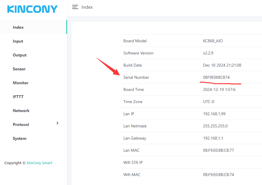

here is feedback from KC868-AIO mqtt state:
Code: {"input1":{"value":false},"input2":{"value":false},"input3":{"value":false},"input4":{"value":false},"input5":{"value":false},"input6":{"value":false},"input7":{"value":false},"input8":{"value":false},"input9":{"value":false},"input10":{"value":false},"input11":{"value":false},"input12":{"value":false},"input13":{"value":false},"input14":{"value":false},"input15":{"value":false},"input16":{"value":false},"input17":{"value":false},"input18":{"value":false},"input19":{"value":false},"input20":{"value":false},"input21":{"value":false},"input22":{"value":false},"input23":{"value":false},"input24":{"value":false},"input25":{"value":false},"input26":{"value":false},"input27":{"value":false},"input28":{"value":false},"input29":{"value":false},"input30":{"value":false},"input31":{"value":false},"input32":{"value":false},"input33":{"value":false},"input34":{"value":false},"input35":{"value":false},"input36":{"value":false},"input37":{"value":false},"input38":{"value":false},"input39":{"value":false},"input40":{"value":false},"input41":{"value":false},"input42":{"value":false},"input43":{"value":false},"input44":{"value":false},"input45":{"value":false},"input46":{"value":false},"input47":{"value":false},"input48":{"value":false},"input49":{"value":false},"input50":{"value":false},"input51":{"value":false},"input52":{"value":false},"input53":{"value":false},"input54":{"value":false},"input55":{"value":false},"input56":{"value":false},"output1":{"value":false},"output2":{"value":false},"output3":{"value":false},"output4":{"value":false},"output5":{"value":false},"output6":{"value":false},"output7":{"value":false},"output8":{"value":false},"output9":{"value":false},"output10":{"value":false},"output11":{"value":false},"output12":{"value":false},"output13":{"value":false},"output14":{"value":false},"output15":{"value":false},"output16":{"value":false},"output17":{"value":false},"output18":{"value":false},"output19":{"value":false},"output20":{"value":false},"output21":{"value":false},"output22":{"value":false},"output23":{"value":false},"output24":{"value":false},"output25":{"value":false},"output26":{"value":false},"output27":{"value":false},"output28":{"value":false},"output29":{"value":false},"output30":{"value":false},"output31":{"value":false},"output32":{"value":false},"adc1":{"value":0},"adc2":{"value":0},"adc3":{"value":0},"adc4":{"value":0},"adc5":{"value":0},"adc6":{"value":0},"adc7":{"value":0},"adc8":{"value":0},"adc9":{"value":0},"adc10":{"value":0},"adc11":{"value":0},"adc12":{"value":0},"adc13":{"value":0},"adc14":{"value":0},"adc15":{"value":0},"adc16":{"value":0},"adc17":{"value":0},"adc18":{"value":0},"adc19":{"value":0},"dac1":{"value":0},"dac2":{"value":0},"dac3":{"value":0},"dac4":{"value":0},"dac5":{"value":0},"dac6":{"value":0},"dac7":{"value":0},"dac8":{"value":0},"dac9":{"value":0},"dac10":{"value":0},"dac11":{"value":0},"dac12":{"value":0},"dac13":{"value":0},"dac14":{"value":0},"dac15":{"value":0},"dac16":{"value":0},"sensor1":{"temperature":-100.0,"humidity":-100.0},"sensor2":{"temperature":-100.0,"humidity":-100.0}}
so you can modify the yaml by this way. here is yaml for KC868-AIO, it config for 32 channel digital output and 56 channel digital input ports. You ONLY need to replace with your own UID in "command_topic" and "state_topic" topic.

yaml file download:
AIO-mqtt-HA.txt (Size: 23.81 KB / Downloads: 420)
check your own UID of KC868-AIO at INDEX webpage.
Posts: 17
Threads: 4
Joined: Nov 2024
Hi
Thanks for your reply and support all working great now.
