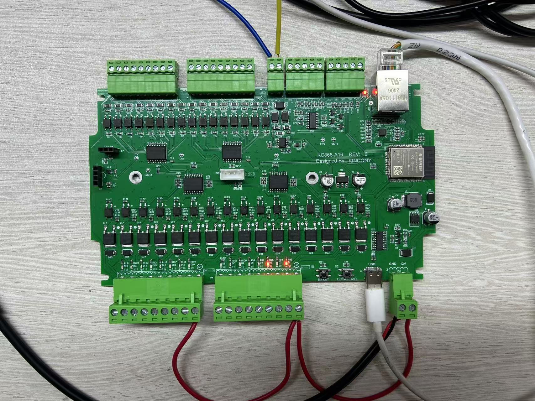

(01-14-2025, 07:45 AM)charmacf Wrote: is there anything i have to change in the yaml file?
i got it works thanks so much
HI
when I uploaded my yaml, KC868A16 is visible in HA but it does not respond to state changes when I control it from home assistant.
have you worked config ?
this is mine:
  friendly_name: kc868a16

#16
take a photo, how you wire cable. maybe you have not connect with Vin terminal with dc12v. see the photo RED cable.
#17
(01-31-2025, 12:26 AM)admin Wrote: take a photo, how you wire cable. maybe you have not connect with Vin terminal with dc12v. see the photo RED cable.
Yes, it WORKS, that was it, my mistake, sorry, I'm just starting the adventure.
THANK YOU
