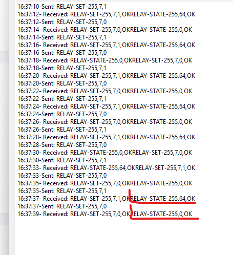

(06-24-2025, 11:16 PM)admin Wrote: can you change to 2s for testing, more delay time.
with 2 seconds no problem
do you have an idea the why I receive the message with STATE if I don'd send RELAY-STATE-255
thank you

you don't need alway send "RELAY-STATE-255" to check state. because even if the relay state changed, it will auto feedback the state message.

(07-03-2025, 02:31 AM)admin Wrote: you don't need alway send "RELAY-STATE-255" to check state. because even if the relay state changed, it will auto feedback the state message.
Sorry for my late reply but I was out
I don't send  RELAY-STATE-255, I send only RELAY-SET.....
thx

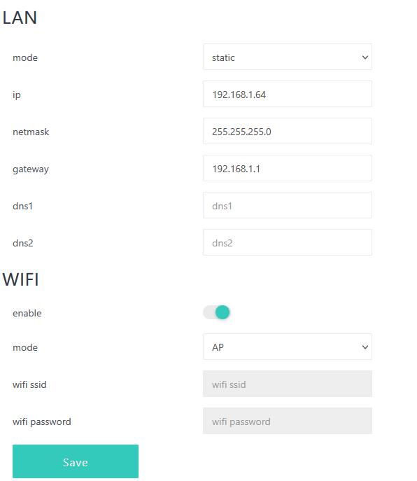

do you have only one of KC868-A8? if have another board, you can test with another KC868-A8 board, whether only one have issue.
another way ,can you set another ip address of this board using STATIC IP address.

(07-16-2025, 12:04 AM)admin Wrote: do you have only one of KC868-A8? if have another board, you can test with another KC868-A8 board, whether only one have issue.
I have only this KC868-A8, I bought it to try
static ip is already set but wifi is impossible to turn off
I'm connected in LAN
