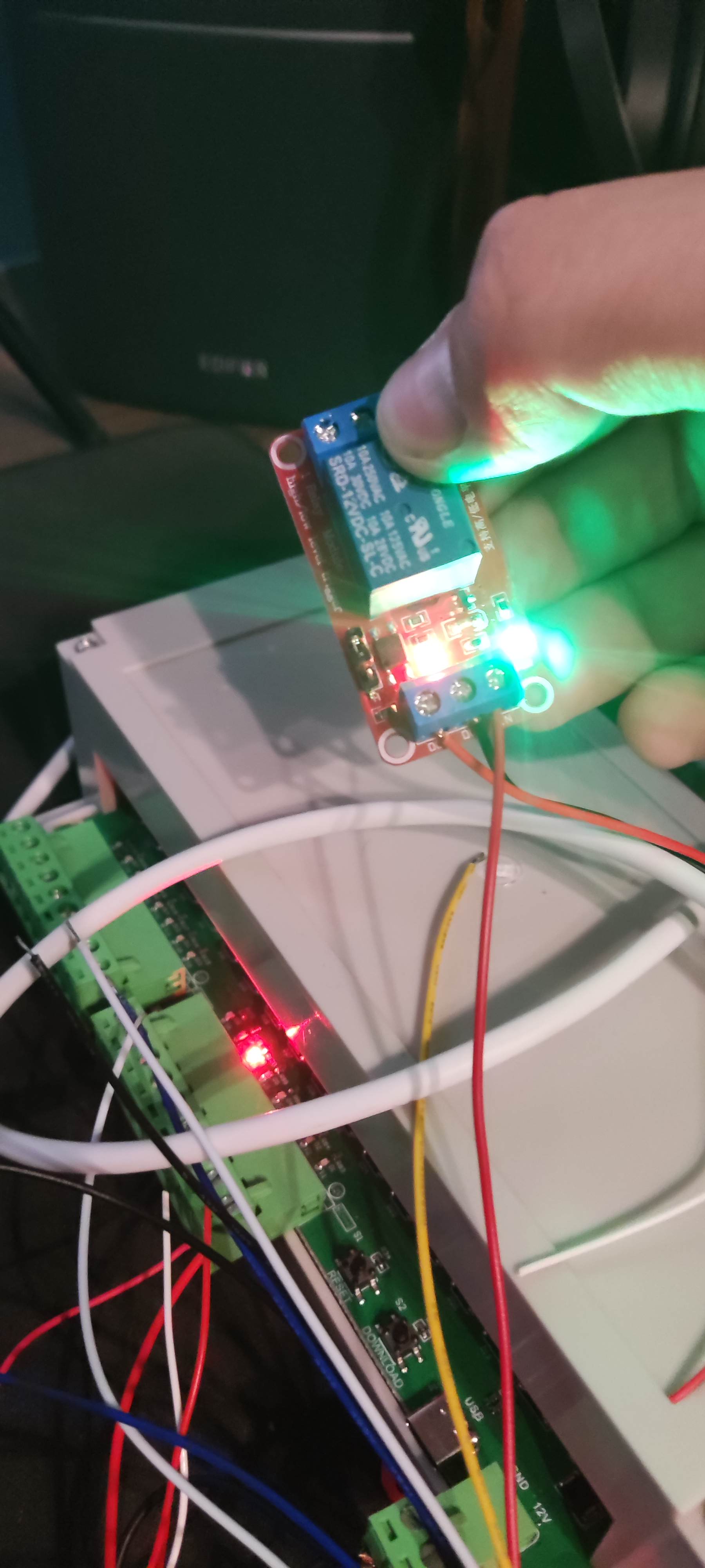

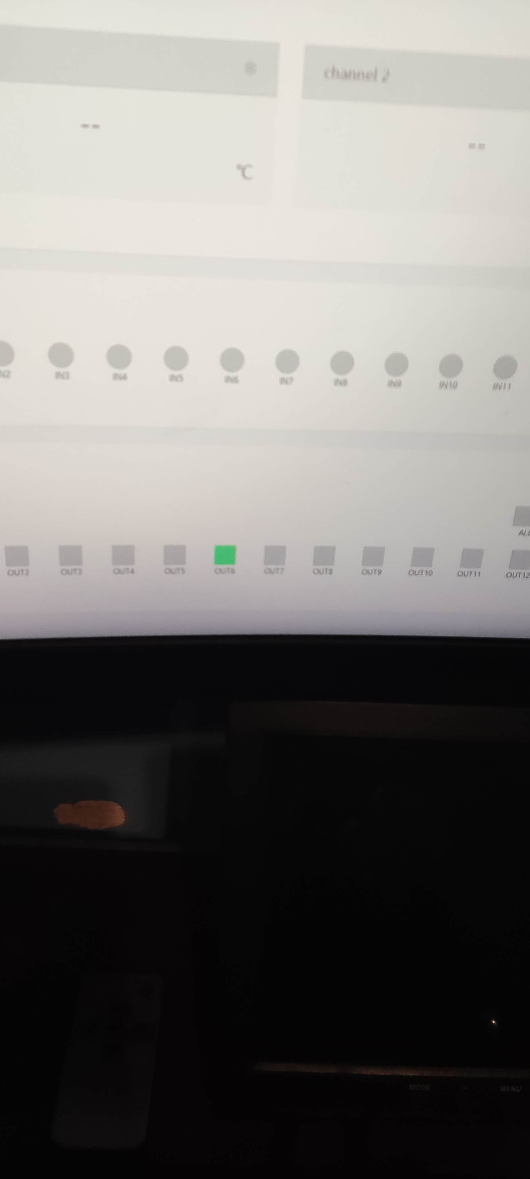

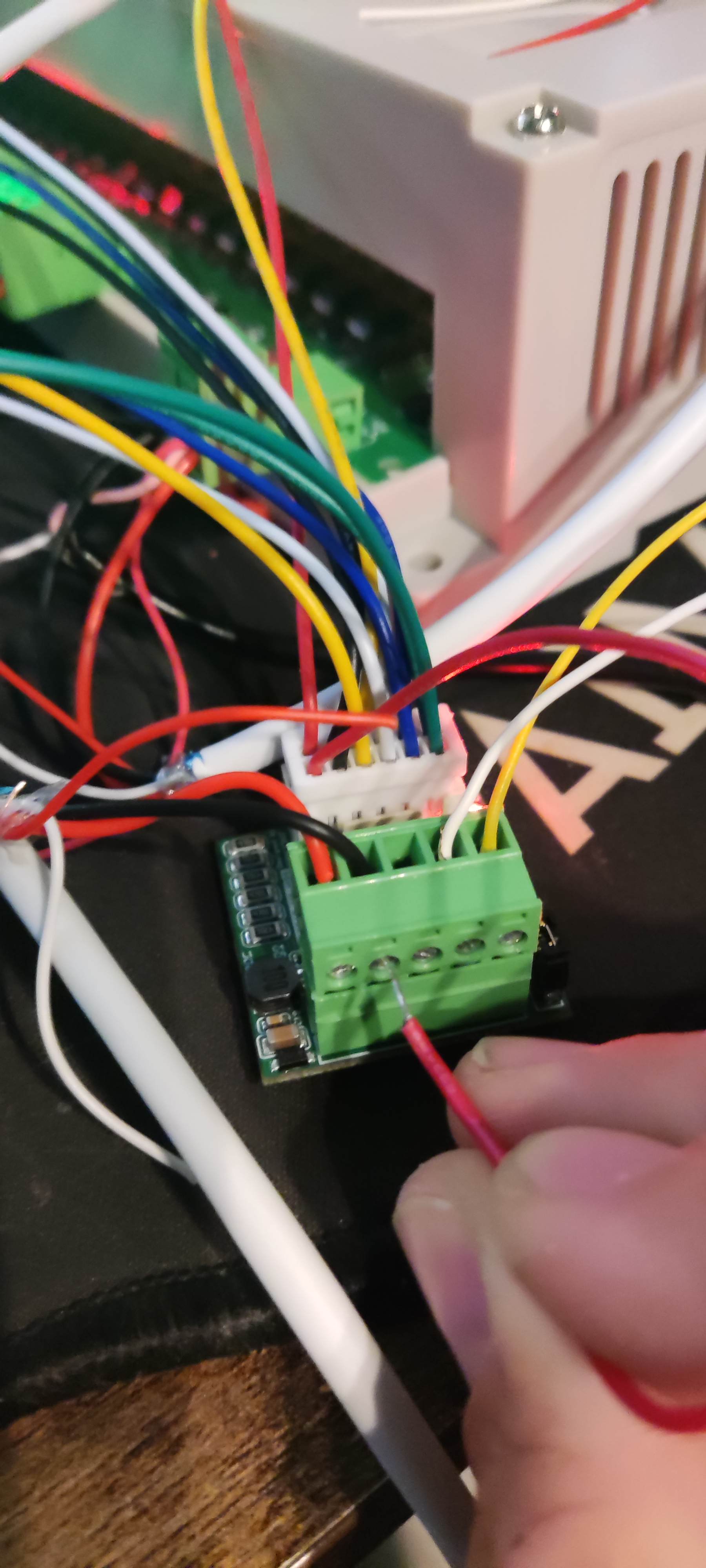

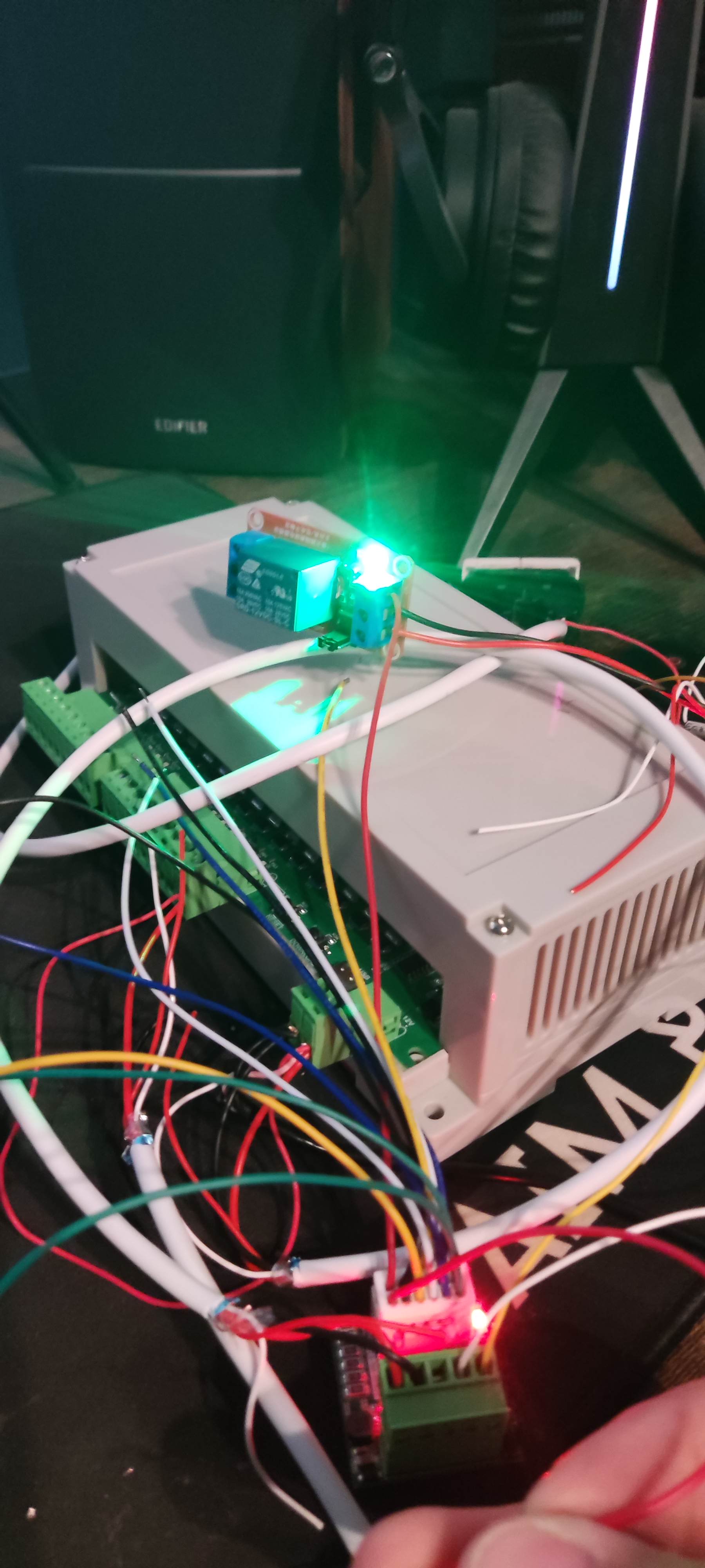

(Yesterday, 10:44 AM)admin Wrote:
(Yesterday, 10:24 AM)Gianfranco Pepi Wrote:
(05-23-2026, 11:28 PM)admin Wrote: KC868-A16 is P mos output, when turn on, it will output 12v or 24v. see this photo, maybe you have not connect with RED cable with "DC" terminal.
If I tried the kc868 a16v3 with your latest firmware version, is the aforementioned board able to set the inputs of the kc868 ha v2 to make the outputs communicate?
sure, it's ok, download KCS v3 firmware, protocol webpage: set RS485 use for HAv2 protocol. so that HAv2 digital input can toggle with KC868-A16v3 output directly.
I managed to get it to work on the board's wired control so far, everything's fine, now I have some doubts! First, why does the output of my kc868 A16 activate? Second, I tried inserting the rs485 string into the IFFFT commands and the relay doesn't activate, can you show me how? Consider that it's address 1 with id10 and all the commands are in Edge event toggle! Ah, I have the kc868 A16v2, but I saw that you listed it as compatible!
