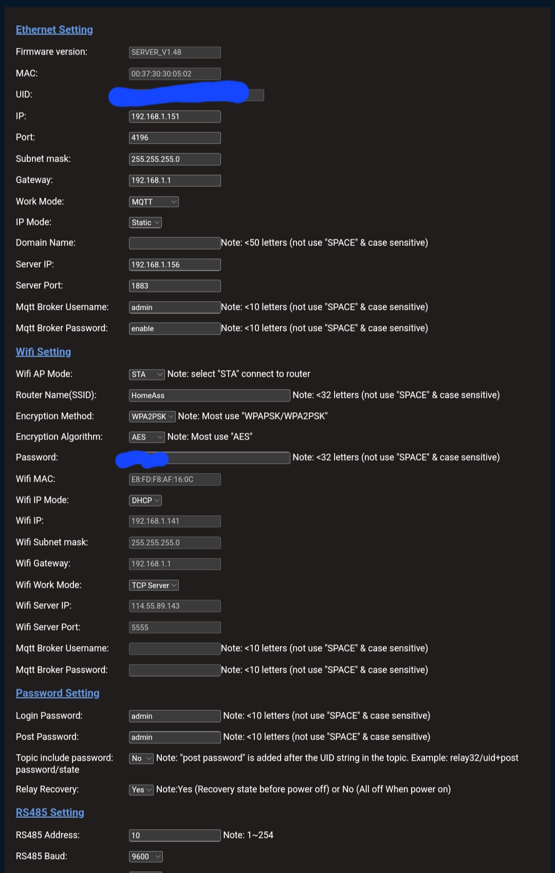

,2.I have a problem with KC SERVER.  10 only 2 are normal (photos of the pingham and the configuration are attached) I checked of course that there is no address conflict with another component I tried to reset the  the wifi but it didn't work out what can be done is there a way to do a factory reset ?

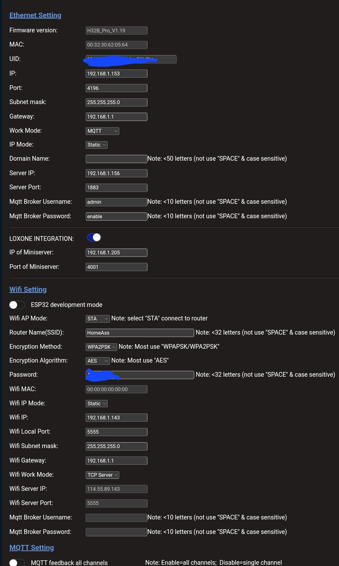

3. I have another wifi problem with one of the H32B PRO type controllers which is unable to connect to the WIFI network at all I don't know if it is related but the MAC address of its WIFI card is 00:00:00:00:00:00 (picture attached) In this case too is there a solution or is there a possibility to do a factory reset indicating that in both cases?

2. suggest use ethernet button set to DHCP mode.
d.) Hold on Ethernet mode button, when the [yellow and white LED] all is ON, release it, then work mode in “UDP” and IP by DHCP mode;
here is online guide: https://www.kincony.com/how-to-use-kc868-server.html
3. Do you means ESP32's wifi? or Tuya module's Wifi? if can't use by ESP32 wifi, do you have download firmware to ESP32 module before? such as whether used Apple HomeKit firmware for ESP32?

2.Maybe I didn't mention about the KC686 server, I'm talking about its wifi component that doesn't connect well and not about the ethernet and I also tried dhcp and it didn't solve the problem,

2. Do you have installed wifi antenna? take a video of your problem is better.
3. do you have download firmware to ESP32 module before? YES or NO ??

In my answer, I refer to both modules, even though the server has a connection to the wifi network, but it is unstable, and in the H32B PRO there is no connection to the WIFI network at all (I also check the connection in the DHCP table on the router)
1. Yes I installed wifi antenna ,I'm not at home, I'll take a video in the evening and upload it later
2. NO I did not download firmware to ESP32 module before
(If I have to do it, I would appreciate it if you added a link to the appropriate firmware for the modules)
#26
you can try to download this factory firmware for ESP32.

I want to confirm with you.

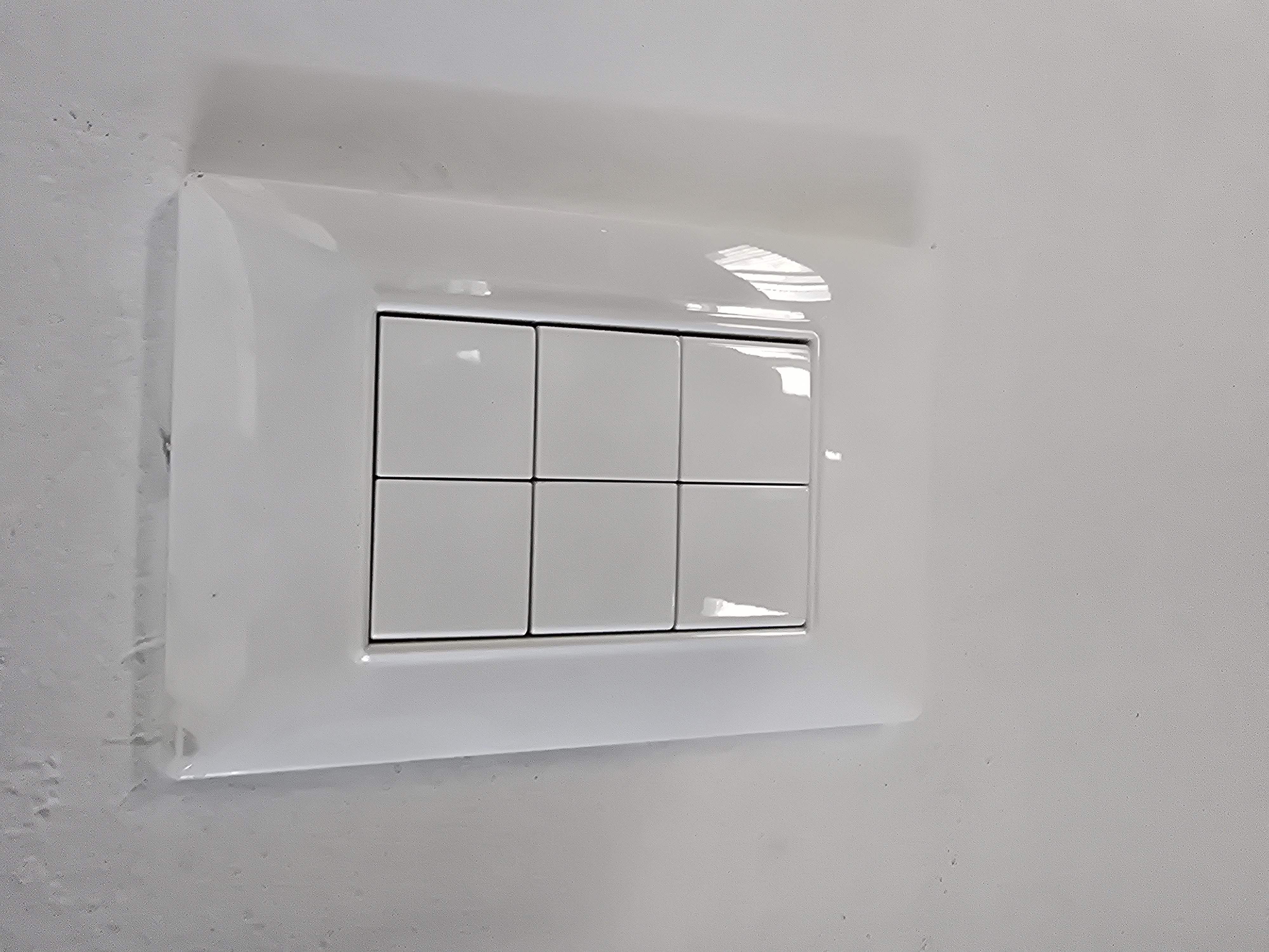

All my switches are push button ((momentary) i add pic)) type so I'm not sure about the function of the toggle but if I need the toggle then I prefer the option that suits me

It fix the problem of H32B PRO now it connect to the wifi
In kc server the factory firmware not fix the problem the connection is still unstable and I lose ping packets
