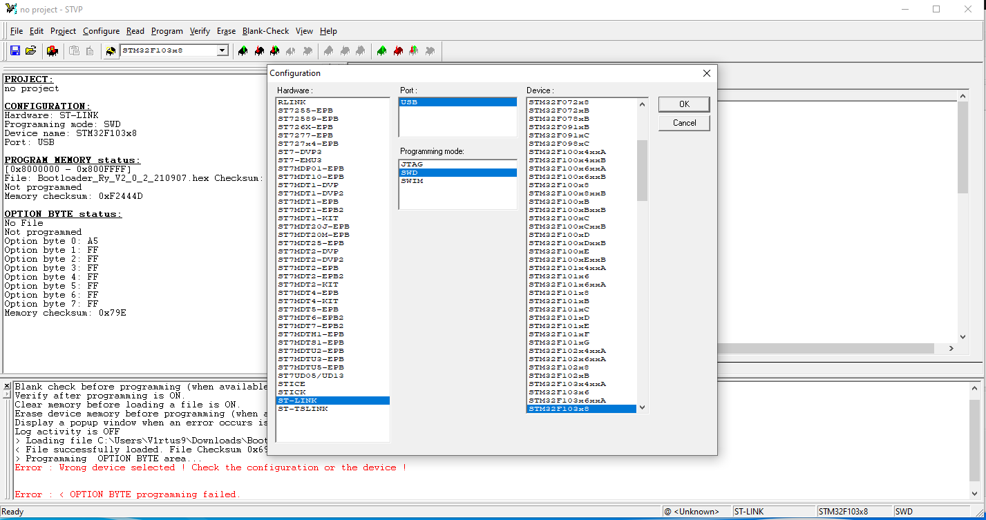

chip list whether have : STM32F103xC ?
because your CPU is STM32F103VCT6

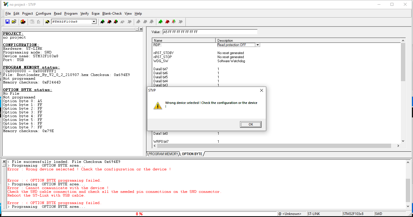

yes, I click the detect button <5 secs after power one, unfortunately it cannot detect a bootloader and no switch is working, is it possible to rollback the bootloader?

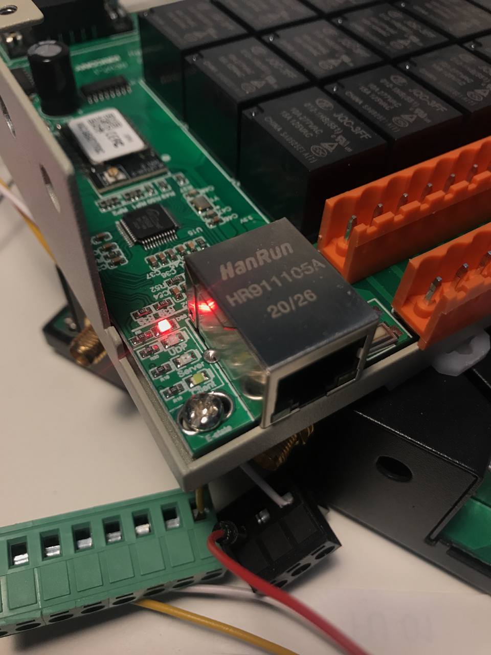

there is no problem with firmware download, I have done it many times already! The problem is that controller only read light is on, it is not reacting to holding any button, I cannot access to it via serial or ethernet.

because now only BOOTLOADER inside, but no firmware inside.
