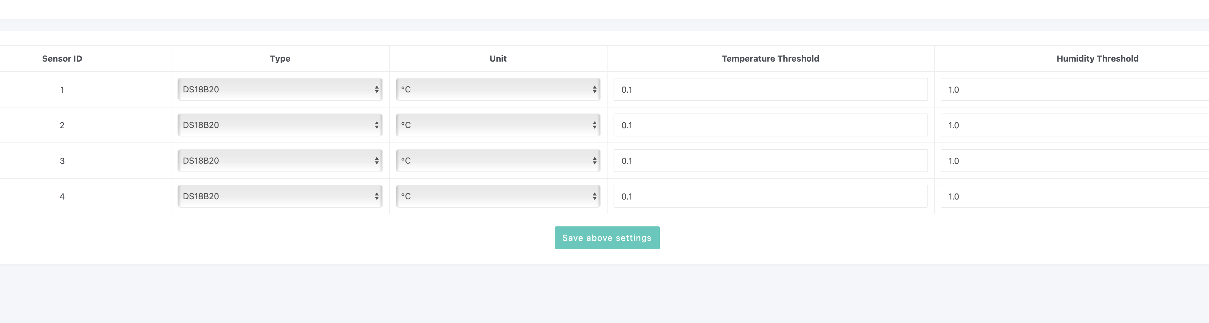

set the threshold value for every sensor in KCS sensor webpage.
so that will auto update to mqtt message when tempetature changed value.
#32
(09-28-2025, 10:50 PM)admin Wrote: set the threshold value for every sensor in KCS sensor webpage.

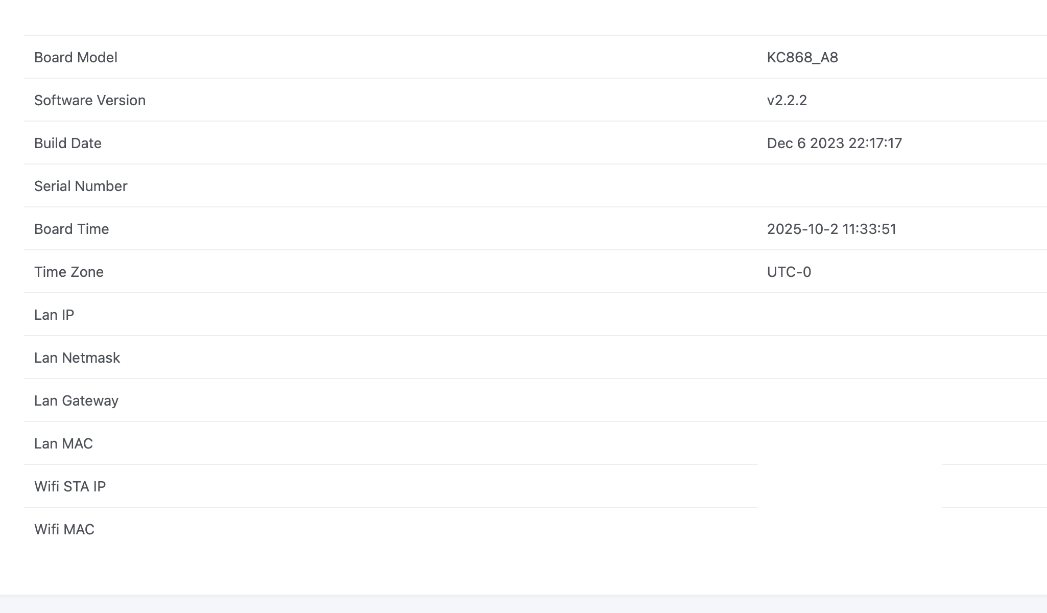

Yes, that was 1st thing to do, unfortunately without preogress.
Honestly, I did not update firmware recently, perhaps that can be an issue.. ? it is still on v2.2.2

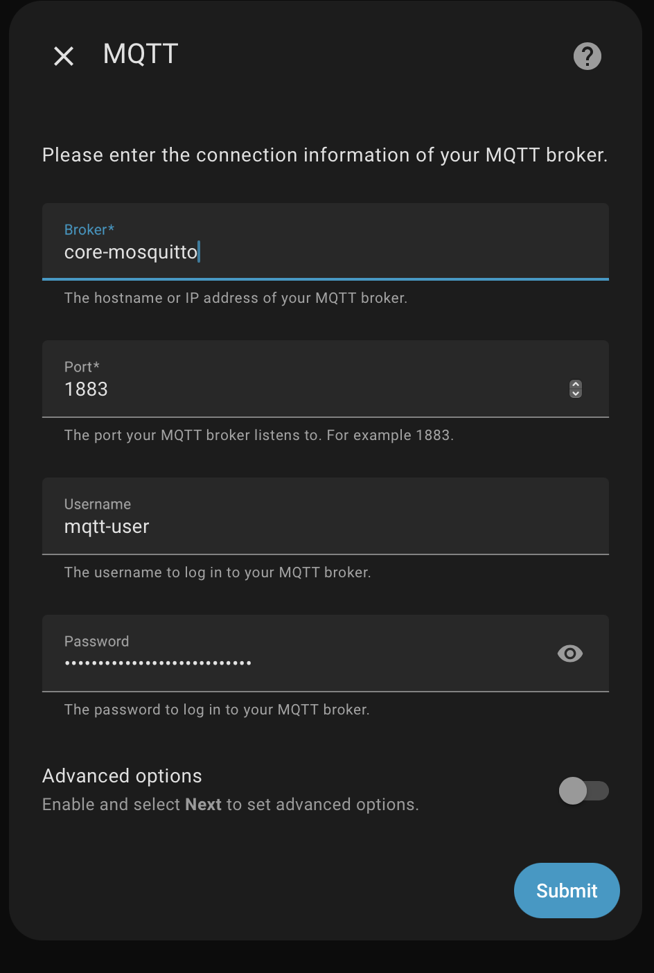

Hello again,
 Firmware updated, unfortunately, now it does not communicate at all with HA.
All credentials are set (user, pass, IP, port) but no luck.
I used v2.2.14, several times downloading stopped due to comm error, can be a cable or something else, but process was finished, everything else is working except MQTT :-)

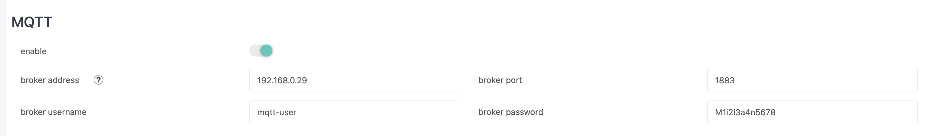

take a photo of your mqtt setting for KC868-A8
#36
(10-04-2025, 11:02 PM)admin Wrote: take a photo of your mqtt setting for KC868-A8

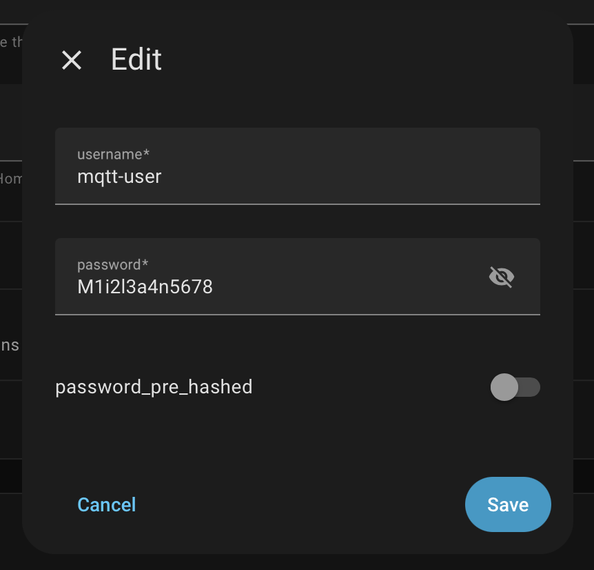

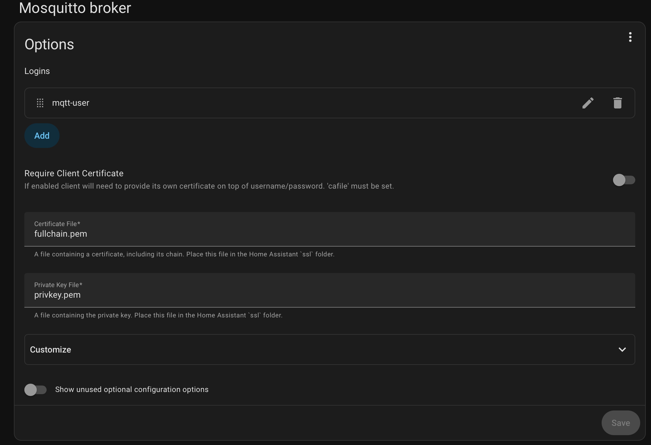

This are the snapshots:

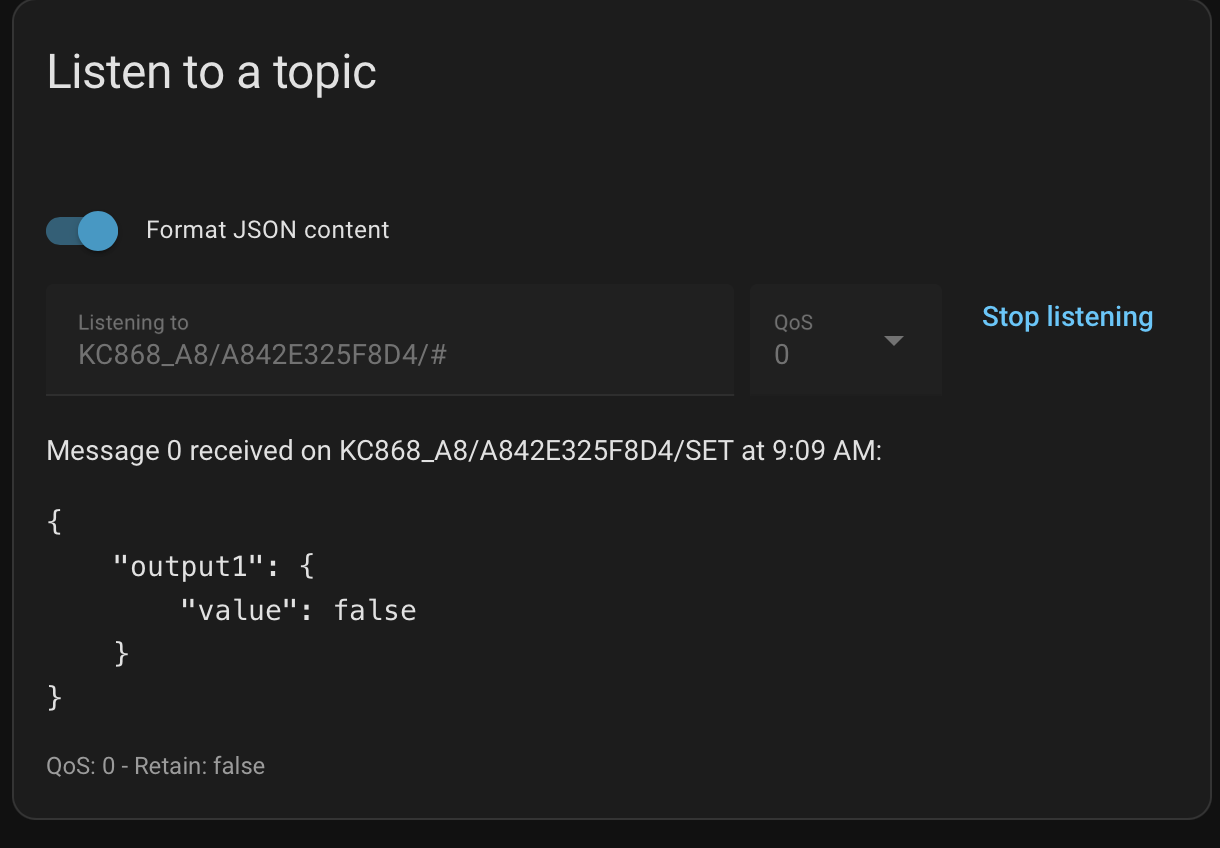

Somehow message appears in listen mode, but sporadic, not constant communication. only for Output_1

Solved,
Stupid mistake in IP, it should be with mqtt://.   :-)
Thanks, everything works fine now !
