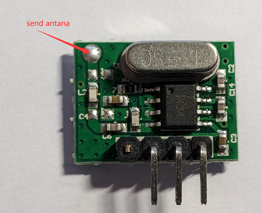

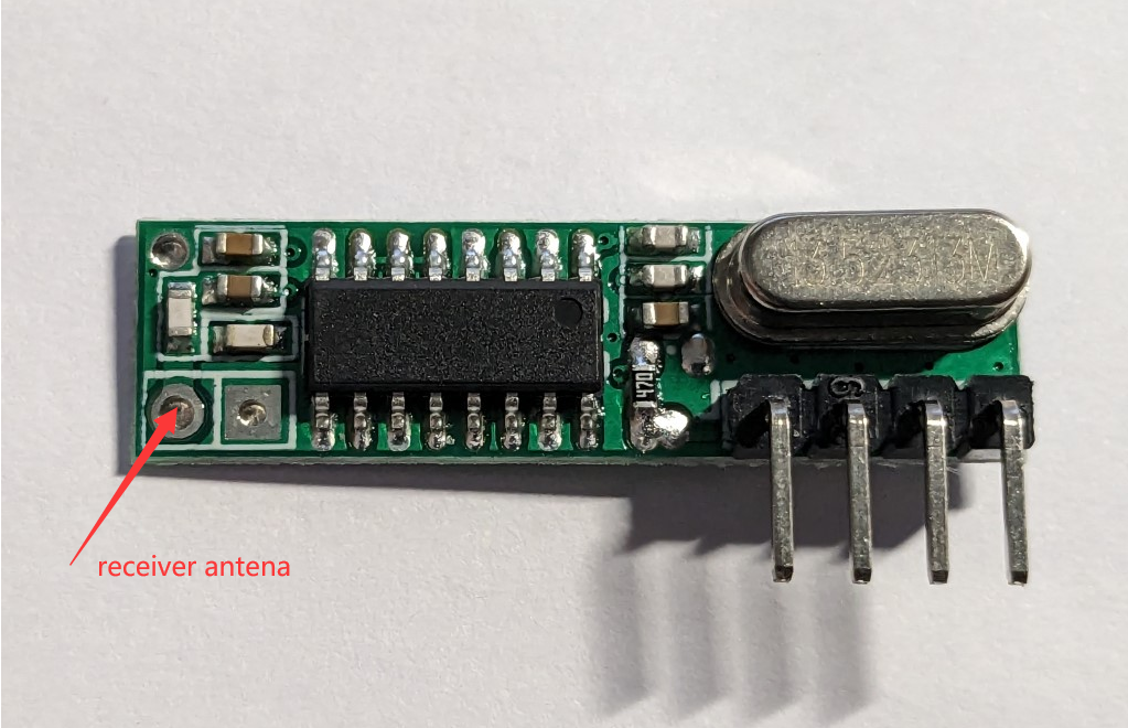

I will install on KC868-A16 board as I got it from you guys.
Which antenna is for sender long or short one?
