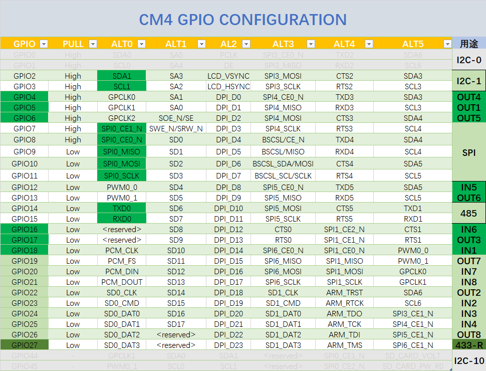

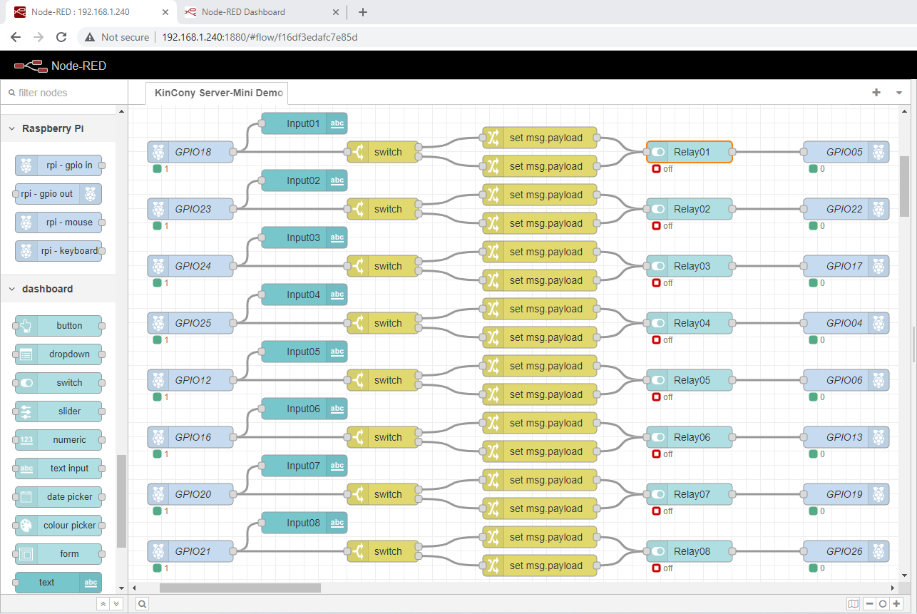

Node-Red demo for Server-Mini use by RELAY and INPUT
Node-Red json file download:
.zip   KinCony_Server_Mini.zip (Size: 2.84 KB / Downloads: 805)
(06-21-2023, 04:07 AM)admin Wrote: The GPIO in and out are not available, what i should do?
do you have installed Node-Red manually? or you installed raspberry pi OS image?
i installed raspberry OS image included Node-Red, that already include Pi node.
i think you can try to check the rpi node whether config correctly.
