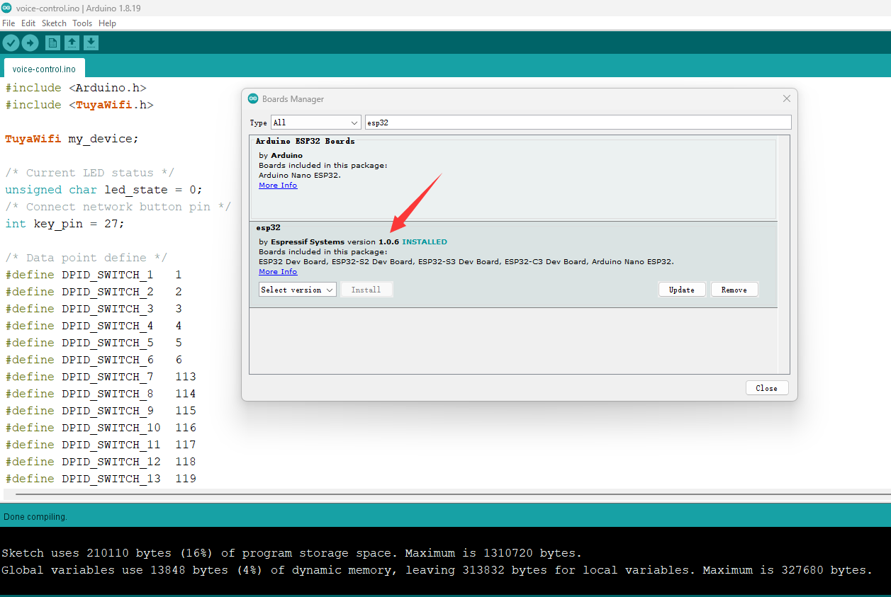

Tuya_ESP32_Adapter virtual switch arduino source code for alexa and Google home speak
firmware BIN file download with address 0x0:
.zip   voice-control_0x0.zip (Size: 116.47 KB / Downloads: 953)
arduino source code:
#include <Arduino.h>
#include <TuyaWifi.h>
TuyaWifi my_device;
/* Current LED status */
unsigned char led_state = 0;
/* Connect network button pin */
int key_pin = 27;

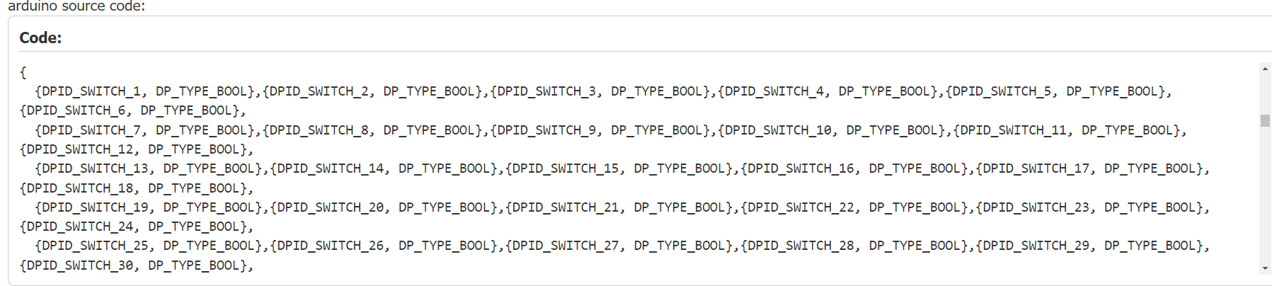

/* Stores all DPs and their types. PS: array[][0]:dpid, array[][1]:dp type.
*                                     dp type(TuyaDefs.h) : DP_TYPE_RAW, DP_TYPE_BOOL, DP_TYPE_VALUE, DP_TYPE_STRING, DP_TYPE_ENUM, DP_TYPE_BITMAP
unsigned char dp_array[][2] =
  {DPID_SWITCH_1, DP_TYPE_BOOL},{DPID_SWITCH_2, DP_TYPE_BOOL},{DPID_SWITCH_3, DP_TYPE_BOOL},{DPID_SWITCH_4, DP_TYPE_BOOL},{DPID_SWITCH_5, DP_TYPE_BOOL},{DPID_SWITCH_6, DP_TYPE_BOOL},
  {DPID_SWITCH_7, DP_TYPE_BOOL},{DPID_SWITCH_8, DP_TYPE_BOOL},{DPID_SWITCH_9, DP_TYPE_BOOL},{DPID_SWITCH_10, DP_TYPE_BOOL},{DPID_SWITCH_11, DP_TYPE_BOOL},{DPID_SWITCH_12, DP_TYPE_BOOL},
  {DPID_SWITCH_13, DP_TYPE_BOOL},{DPID_SWITCH_14, DP_TYPE_BOOL},{DPID_SWITCH_15, DP_TYPE_BOOL},{DPID_SWITCH_16, DP_TYPE_BOOL},{DPID_SWITCH_17, DP_TYPE_BOOL},{DPID_SWITCH_18, DP_TYPE_BOOL},
  {DPID_SWITCH_19, DP_TYPE_BOOL},{DPID_SWITCH_20, DP_TYPE_BOOL},{DPID_SWITCH_21, DP_TYPE_BOOL},{DPID_SWITCH_22, DP_TYPE_BOOL},{DPID_SWITCH_23, DP_TYPE_BOOL},{DPID_SWITCH_24, DP_TYPE_BOOL},
  {DPID_SWITCH_25, DP_TYPE_BOOL},{DPID_SWITCH_26, DP_TYPE_BOOL},{DPID_SWITCH_27, DP_TYPE_BOOL},{DPID_SWITCH_28, DP_TYPE_BOOL},{DPID_SWITCH_29, DP_TYPE_BOOL},{DPID_SWITCH_30, DP_TYPE_BOOL},
{DPID_SWITCH_31, DP_TYPE_BOOL},{DPID_SWITCH_32, DP_TYPE_BOOL},

      //Status changes should be reported.
      my_device.mcu_dp_update(DPID_SWITCH_25, switch_25_state, length);
    break;
    case DPID_SWITCH_26:
      switch_26_state = my_device.mcu_get_dp_download_data(dpid, value, length); /* Get the value of the down DP command */
      my_device.mcu_dp_update(DPID_SWITCH_26, switch_26_state, length);
    break;
    case DPID_SWITCH_27:
      switch_27_state = my_device.mcu_get_dp_download_data(dpid, value, length); /* Get the value of the down DP command */
      my_device.mcu_dp_update(DPID_SWITCH_27, switch_27_state, length);
    break;
    case DPID_SWITCH_28:
      switch_28_state = my_device.mcu_get_dp_download_data(dpid, value, length); /* Get the value of the down DP command */
      my_device.mcu_dp_update(DPID_SWITCH_28, switch_28_state, length);
    break;
    case DPID_SWITCH_29:
      switch_29_state = my_device.mcu_get_dp_download_data(dpid, value, length); /* Get the value of the down DP command */
      my_device.mcu_dp_update(DPID_SWITCH_29, switch_29_state, length);
    break;
    case DPID_SWITCH_30:
      switch_30_state = my_device.mcu_get_dp_download_data(dpid, value, length); /* Get the value of the down DP command */
      my_device.mcu_dp_update(DPID_SWITCH_30, switch_30_state, length);
    break;
    case DPID_SWITCH_31:
      switch_31_state = my_device.mcu_get_dp_download_data(dpid, value, length); /* Get the value of the down DP command */
      my_device.mcu_dp_update(DPID_SWITCH_31, switch_31_state, length);
    break;
    case DPID_SWITCH_32:
      switch_32_state = my_device.mcu_get_dp_download_data(dpid, value, length); /* Get the value of the down DP command */
      my_device.mcu_dp_update(DPID_SWITCH_32, switch_32_state, length);
    break;
    default:break;
  return TY_SUCCESS;
* @description: Upload all DP status of the current device.
* @param {*}
* @return {*}
void dp_update_all(void)
  my_device.mcu_dp_update(DPID_SWITCH_1, switch_1_state, 1);
  my_device.mcu_dp_update(DPID_SWITCH_2, switch_2_state, 1);
  my_device.mcu_dp_update(DPID_SWITCH_3, switch_3_state, 1);
  my_device.mcu_dp_update(DPID_SWITCH_4, switch_4_state, 1);
  my_device.mcu_dp_update(DPID_SWITCH_5, switch_5_state, 1);
  my_device.mcu_dp_update(DPID_SWITCH_6, switch_6_state, 1);
  my_device.mcu_dp_update(DPID_SWITCH_7, switch_7_state, 1);
  my_device.mcu_dp_update(DPID_SWITCH_8, switch_8_state, 1);
  my_device.mcu_dp_update(DPID_SWITCH_9, switch_9_state, 1);
  my_device.mcu_dp_update(DPID_SWITCH_10, switch_10_state, 1);
  my_device.mcu_dp_update(DPID_SWITCH_11, switch_11_state, 1);
  my_device.mcu_dp_update(DPID_SWITCH_12, switch_12_state, 1);
  my_device.mcu_dp_update(DPID_SWITCH_13, switch_13_state, 1);
  my_device.mcu_dp_update(DPID_SWITCH_14, switch_14_state, 1);
  my_device.mcu_dp_update(DPID_SWITCH_15, switch_15_state, 1);
  my_device.mcu_dp_update(DPID_SWITCH_16, switch_16_state, 1);
  my_device.mcu_dp_update(DPID_SWITCH_17, switch_17_state, 1);
  my_device.mcu_dp_update(DPID_SWITCH_18, switch_18_state, 1);
  my_device.mcu_dp_update(DPID_SWITCH_19, switch_19_state, 1);
  my_device.mcu_dp_update(DPID_SWITCH_20, switch_20_state, 1);
  my_device.mcu_dp_update(DPID_SWITCH_21, switch_21_state, 1);
  my_device.mcu_dp_update(DPID_SWITCH_22, switch_22_state, 1);
  my_device.mcu_dp_update(DPID_SWITCH_23, switch_23_state, 1);
  my_device.mcu_dp_update(DPID_SWITCH_24, switch_24_state, 1);
  my_device.mcu_dp_update(DPID_SWITCH_25, switch_25_state, 1);
  my_device.mcu_dp_update(DPID_SWITCH_26, switch_26_state, 1);
  my_device.mcu_dp_update(DPID_SWITCH_27, switch_27_state, 1);
  my_device.mcu_dp_update(DPID_SWITCH_28, switch_28_state, 1);
  my_device.mcu_dp_update(DPID_SWITCH_29, switch_29_state, 1);
  my_device.mcu_dp_update(DPID_SWITCH_30, switch_30_state, 1);
  my_device.mcu_dp_update(DPID_SWITCH_31, switch_31_state, 1);
  my_device.mcu_dp_update(DPID_SWITCH_32, switch_32_state, 1);
Puedo hacer Toggle con tuya?
just for ON/OFF control. But you can modify the source code for TOGGLE.
(02-24-2024, 10:33 PM)admin Wrote: just for ON/OFF control. But you can modify the source code for TOGG
which part the code can change?
just modify every control relay's function in arduino code. If you are not familiar with Arduino, it is not recommended that you modify it.
