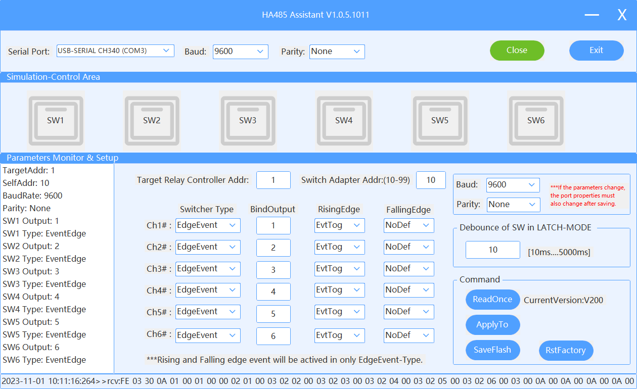

Hi there,
I have two questions:
- Is the PC Software also available for Linux?
- Is it possible to change the Baudrate of the KC868-HA-V2. I have other stuff on my RS485-Bus which needs different Baudrate.
Thanks very much in advance.
Hi there again,
ok, I found out how to change the baudrate.
I changed it to 57600 baud without parity. That worked.
But I need 57600 baud with parity even. It seems that setting parity doesn't work. I tried it with even and odd.
Could you please check that.
My firmware version is V200
Martin

(02-27-2024, 10:51 AM)admin Wrote: KC868-AP not support HA board.
I already used it with KC868-AP and EspHome. It worked with a slower baudrate.
The only problem I have is that I cannot set the right parity. I think it is a bug in HA firmware.
HAv2 support change baudrate by PC software.
(02-27-2024, 10:24 PM)admin Wrote: HAv2 support change baudrate by PC software
Yes I know. As I said I already did that. But setting parity to anything different than "none" does NOT work. This is why I think there is an error in the firmware of HAv2 or the PC software.
do you means, the partity only work for "NONE"?
