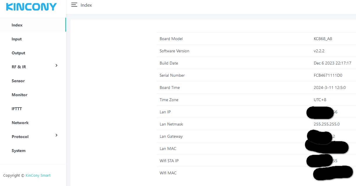

Hello

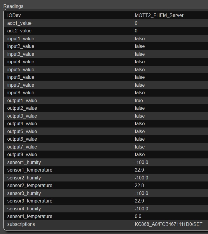

I have set the Temperature Threshold to 0.1.
The numbers are changing when th relais are change or the adc numbers only!!! (another user have the same problem!)

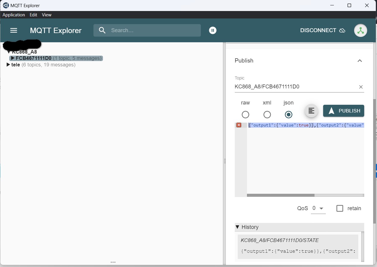

To switch the relais from my MQTT server I test it with :
set MQTT2_FCB4671111D0 output1_valve true
set MQTT2_FCB4671111D0 output1_value on
set MQTT2_FCB4671111D0 output1_valve on
set MQTT2_FCB4671111D0 output1 on/off/true/false
nothing work

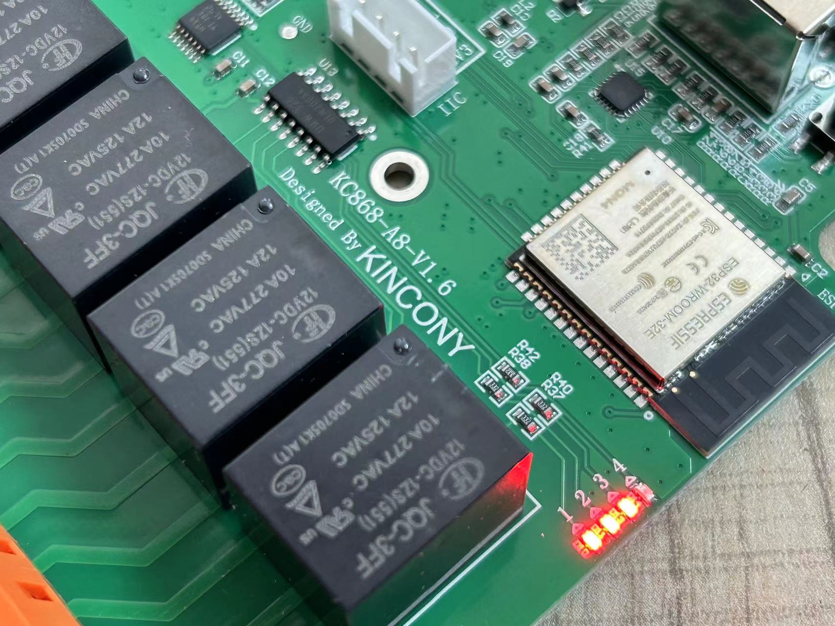

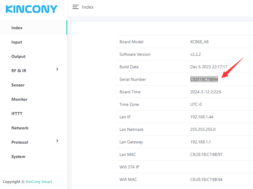

1. i don't know which board you are using? what sensor you are using? how you wire? take photo!
2. take a screen photo what command you have send to control relay.

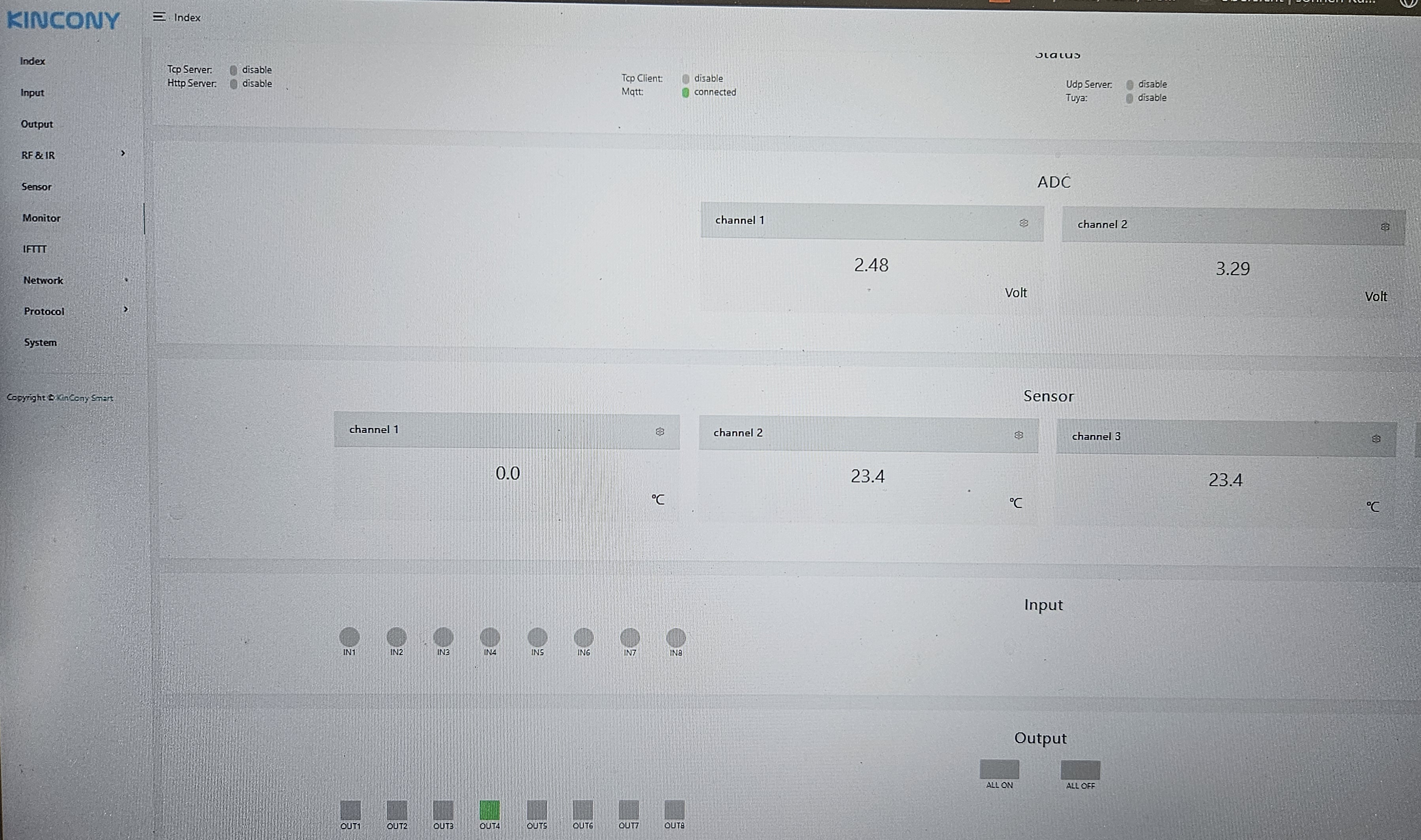

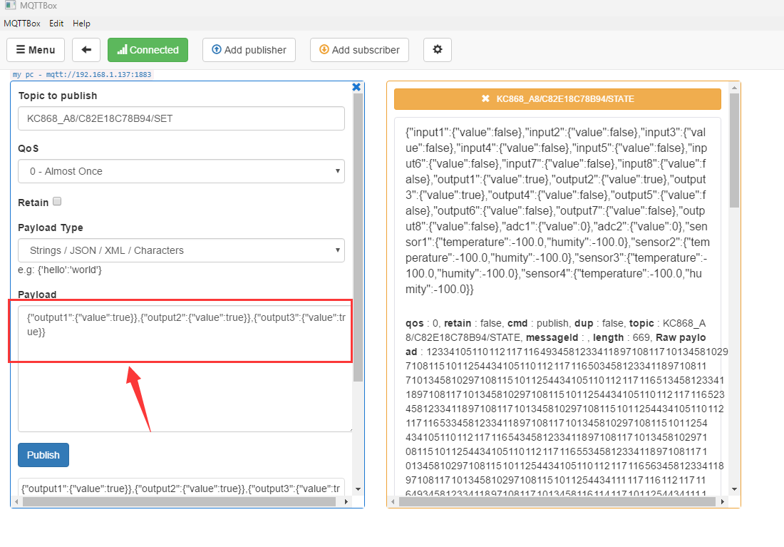

1. Can you control relay ON/OFF by mqtt command now?
2. after you download KCS firmware, "Monitor" webpage showed config value, you can preset the range and unit. the MQTT feedback "2535", that is RAW code.
for example: 0---4095 RAW code can set to 0--5V or 0--10 meter or ......
