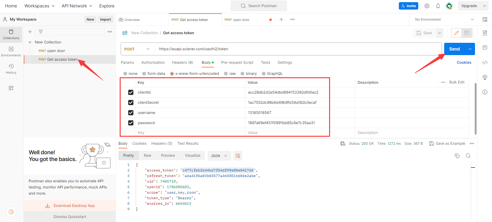

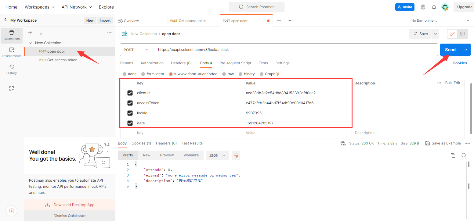

how to integrate smart door lock to Loxone miniserver by cloud server API
1. make sure you can use your mobile phone app remote control your door lock.
2. Door lock supplier website registration developer account
3. after "approved" your developer account, will get a "client_id“,”client_secret"
4. Get access token
5. unlock door

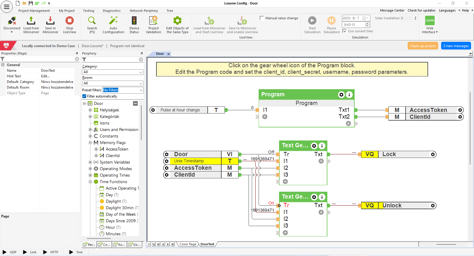

integrate to Loxone miniserver:
Loxone config project file:
.zip   Door.zip (Size: 15.76 KB / Downloads: 698)
.zip   door.c.zip (Size: 854 bytes / Downloads: 715)
.pdf   LoxoneDoor.pdf (Size: 171.81 KB / Downloads: 1,051)

the video use by TTLOCK without any gateway. just send command to TTLOCK's cloud server directly.
Hi
What is the purpose of the input on I1 (pulse pr hour change). Whill this run the script every hour?
Can't find the program code for this...
