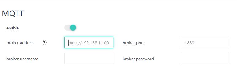

I load the firmware KCS_KC868_A16_V2.2.2.bin, but when enable MQTT flag I can't change the default ip broker 192.168.1.100. And after enabled MQTT I don't see anymore the KC868-A16 in the lan

"I can't change the default ip broker 192.168.1.100", take a photo how can't change?

why can't input? use mouse click the edit section, then input. if you can't , take a video , send to whatsapp number: +86-15381188302

(04-05-2024, 03:38 PM)GibKat Wrote:(04-05-2024, 12:06 PM)admin Wrote: why can't input? use mouse click the edit section, then input. if you can't , take a video , send to whatsapp number: +86-15381188302 Gray is a prompt message, why don't you try clicking with the mouse and then entering the information????
