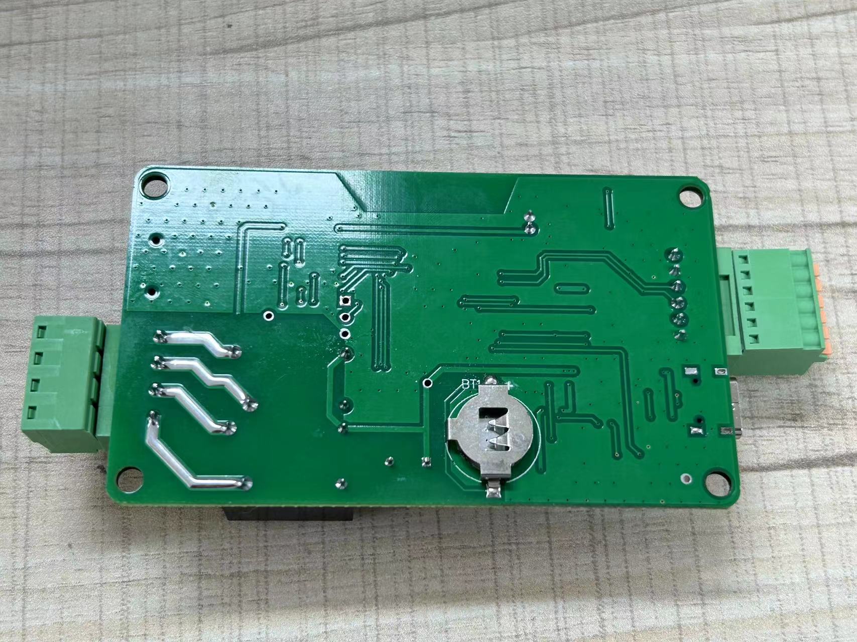

because it's not easy to battery by air plane, so if you want timer work when power off, you can install the CR1220 on KC868-ASR PCB bottom side.
