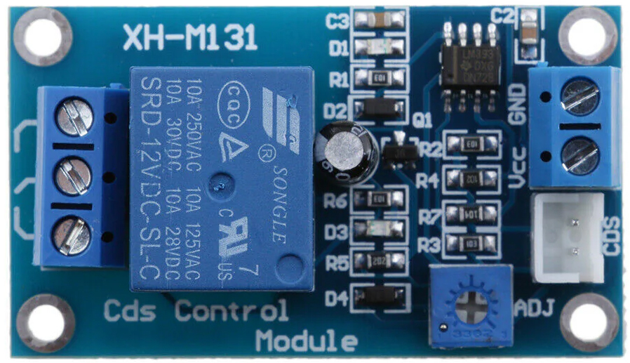

Okay, thanks. The blue light in the video is coming from a XH M131 CDS control module with the NO going to input pin 10 and NC going to input pin 9 and center pin going to GRD on the A16.

because KCS V1 use simple code link digital input with digital output.
because KCS V2 support IFTTT, it has many threads that require time to process, such as every time when digital input triggered, will calculate the time, use for 1-click,2-click , hold on ......etc. so if you want use KCS v2, not send signal too fast, you can change the speed of input pulse. Because v2 has added many new features and is quite complex, it will sacrifice some performance
