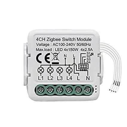

I want to use the RF remote to on/off a Zigbee based switch, I was able to find the RF option. How can i configure the Zigbee Switch to on and off?
our firmware no zigbee function now. do your zigbee device support HTTP command for integration?
if YES, you can use IFTTT command, RF trigger zigbee device.
[attachment=5689 Wrote:pid='15497' dateline='1722259172']
This is the switch, I am not sure if this supports what you are asking for.
