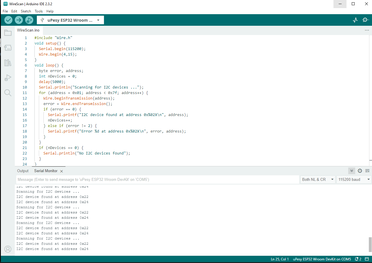

ok, the problem is the DS1307 chip bad?

yes, you can try, i think will be ok, someone have done successfully.
he said: " After checking the DS1307 datasheet, I found a note mentioning the chip malfunctioning when using a diode in series with the "Vbat" pin. I removed diodes D5 and D7 from the board, and put a Jump in place of D7, and now it's functioning normally. "

I am trying the example code for the ds1307 rtc and it does not work and I see this solution and it is not viable for me. I am in Mexico and I also do not have the tool to desolder and I have doubts about how to do it
