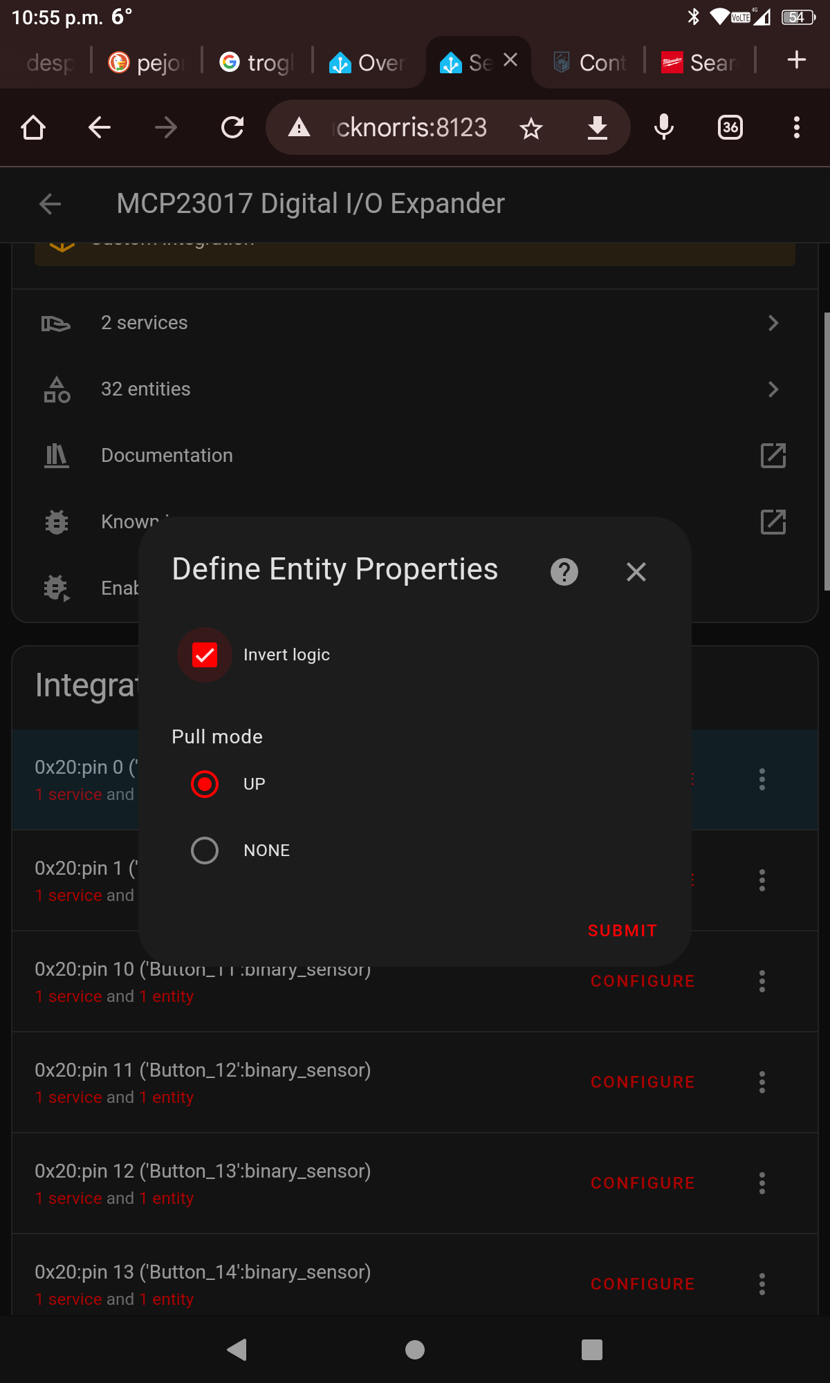

ok, thank you for reply, Im not 100% sure I understand but here is YAML for the area of concern, the others sensors are GPIO but arent working right now because that integration has ebeen deprecated or abandonded. I see where to change the invert logic " en masse" , is this the same as going into integration entities and configuring each individual pin as invert logic ( box IS currenlty checked ) and pull mode is "UP" ?

you can test with "check" or "uncheck" with "Invert logic". This is correct option.
not need to use "Pull mode"
