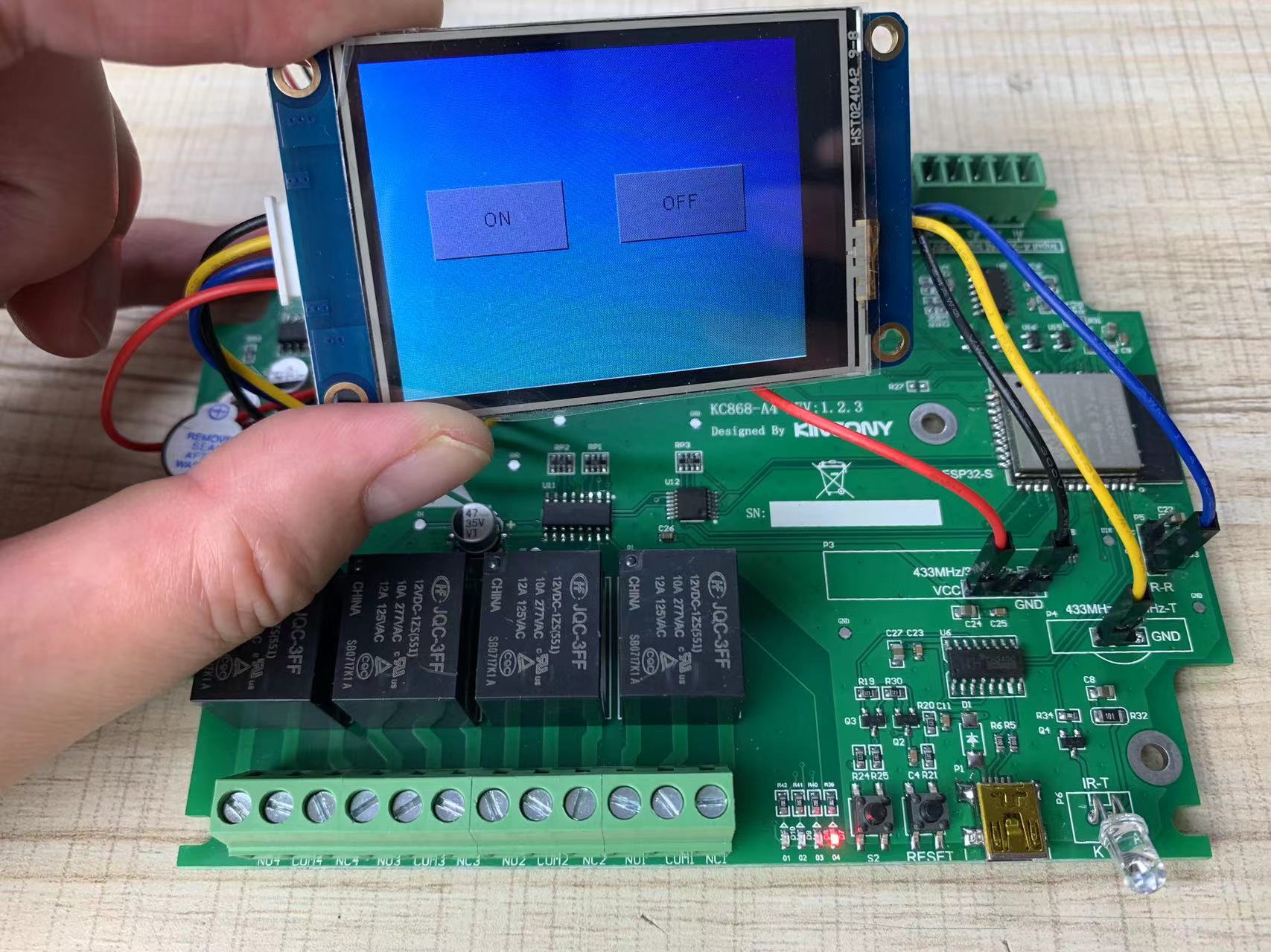

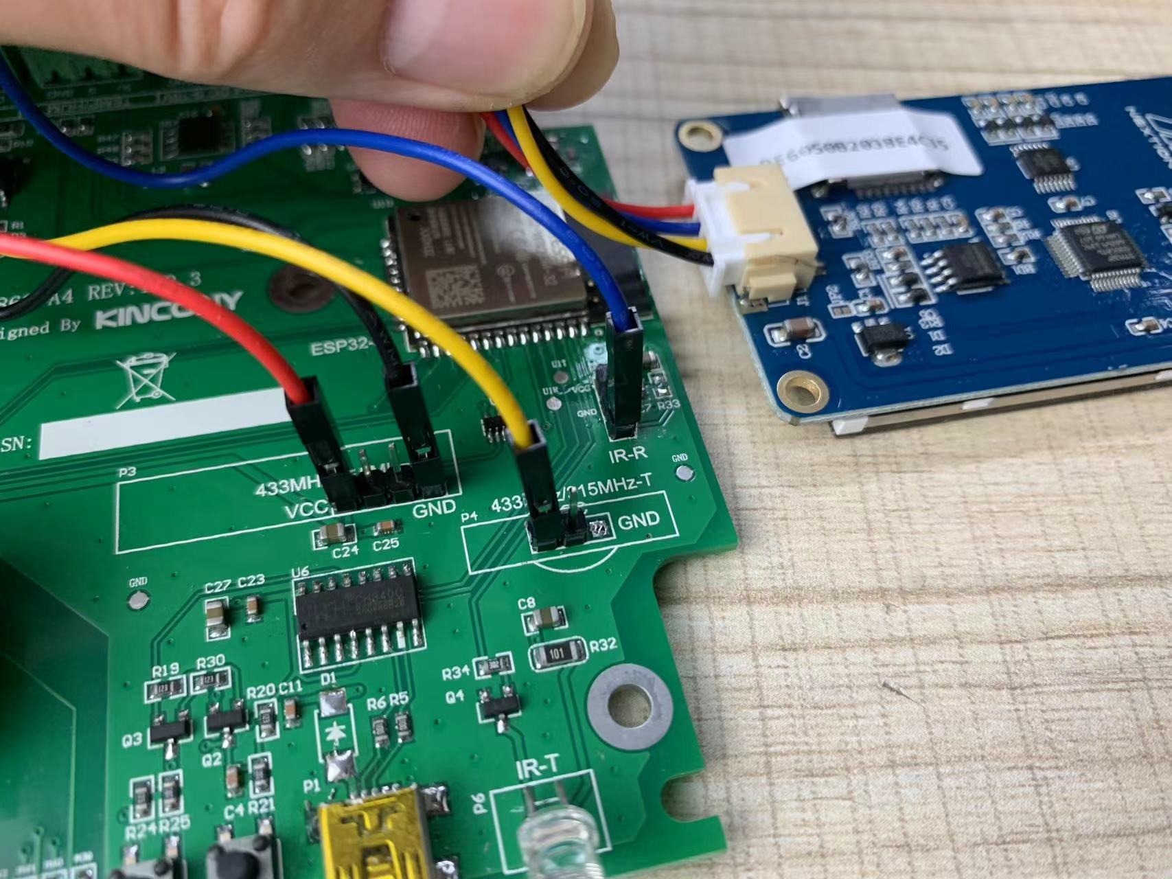

i have removed RF433M receiver, RF433M sender and IR receiver. actually use want to use VCC,GND,RXD,TXD for Nextion display.
define RXD:GPIO23 TXD:GPIO21 by ESP32
here are some photos:
This just a simplest demo, use Nextion display two buttons, press button-one will send 'a' by serial port, press button-two will send 'b' by serial port.
when KC868-A4 received 'a' will turn ON relay1, when received 'b' will turn OFF relay1.

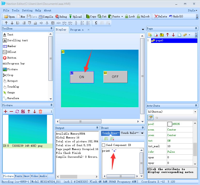

firstly create two buttons UI by Nextion Editor PC software:
here is firmware BIN file, you can download to KC868-A4 ESP32 directly to use:

check your Nextion display whether have connect with VCC,GND,RXD,TXD correctly. you can upload a photo.
(11-06-2024, 11:40 PM)관리자 Wrote: Nextion 디스플레이가 VCC, GND, RXD, TXD에 올바르게 연결되었는지 확인하세요. 사진을 업로드할 수 있습니다.

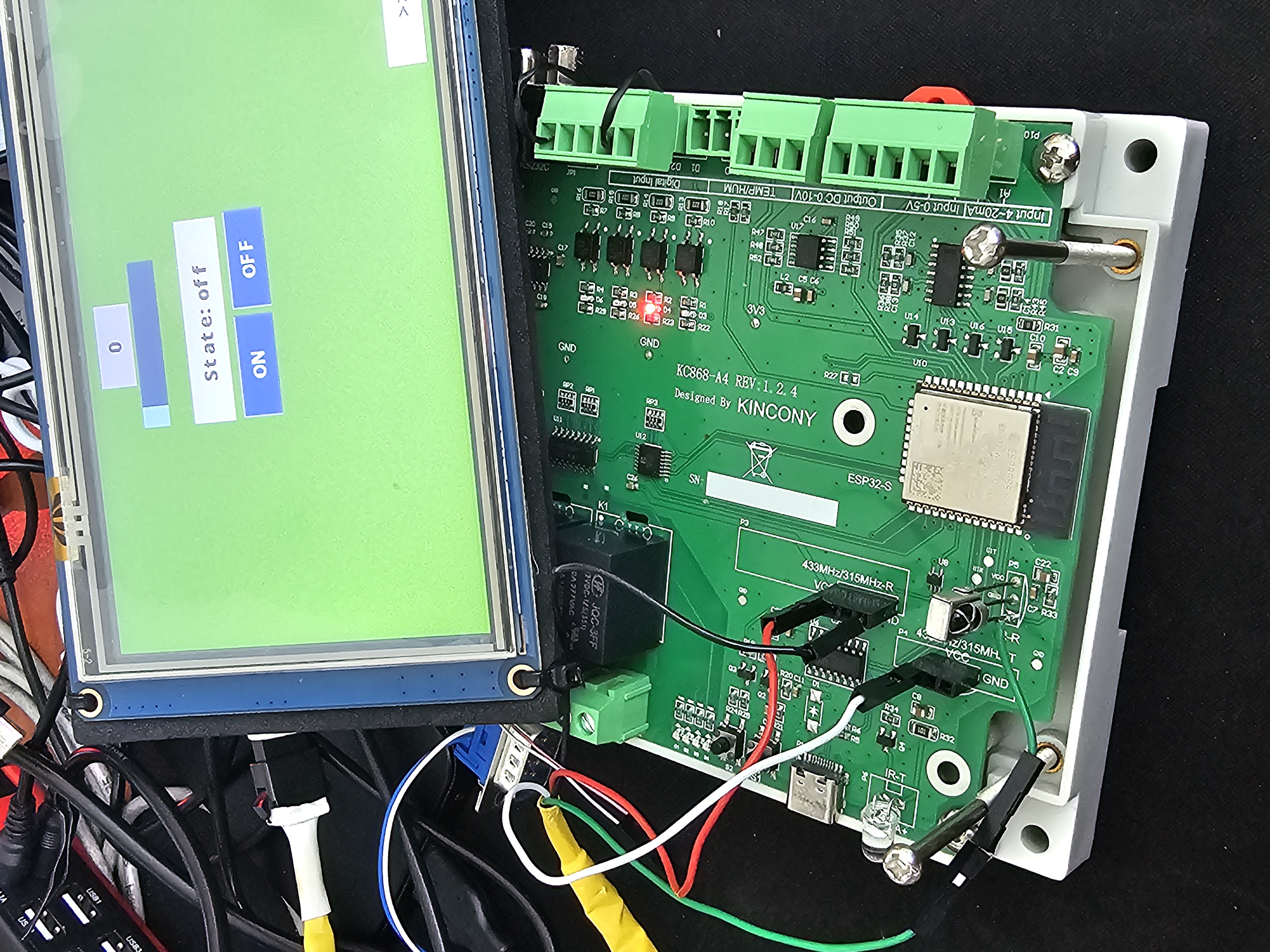

I connected RX,TX like your picture
(11-06-2024, 11:40 PM)admin Wrote: check your Nextion display whether have connect with VCC,GND,RXD,TXD correctly. you can upload a photo.
I use ESP32-WROOM-32E and NEXTION NX8048T050_011.
I downloaded the formware nextion_KC868-A4.ino.nodemcu-32s. I used your example for KC868 coding.
You need remove the IR receiver, see my photo, i have remove it.
