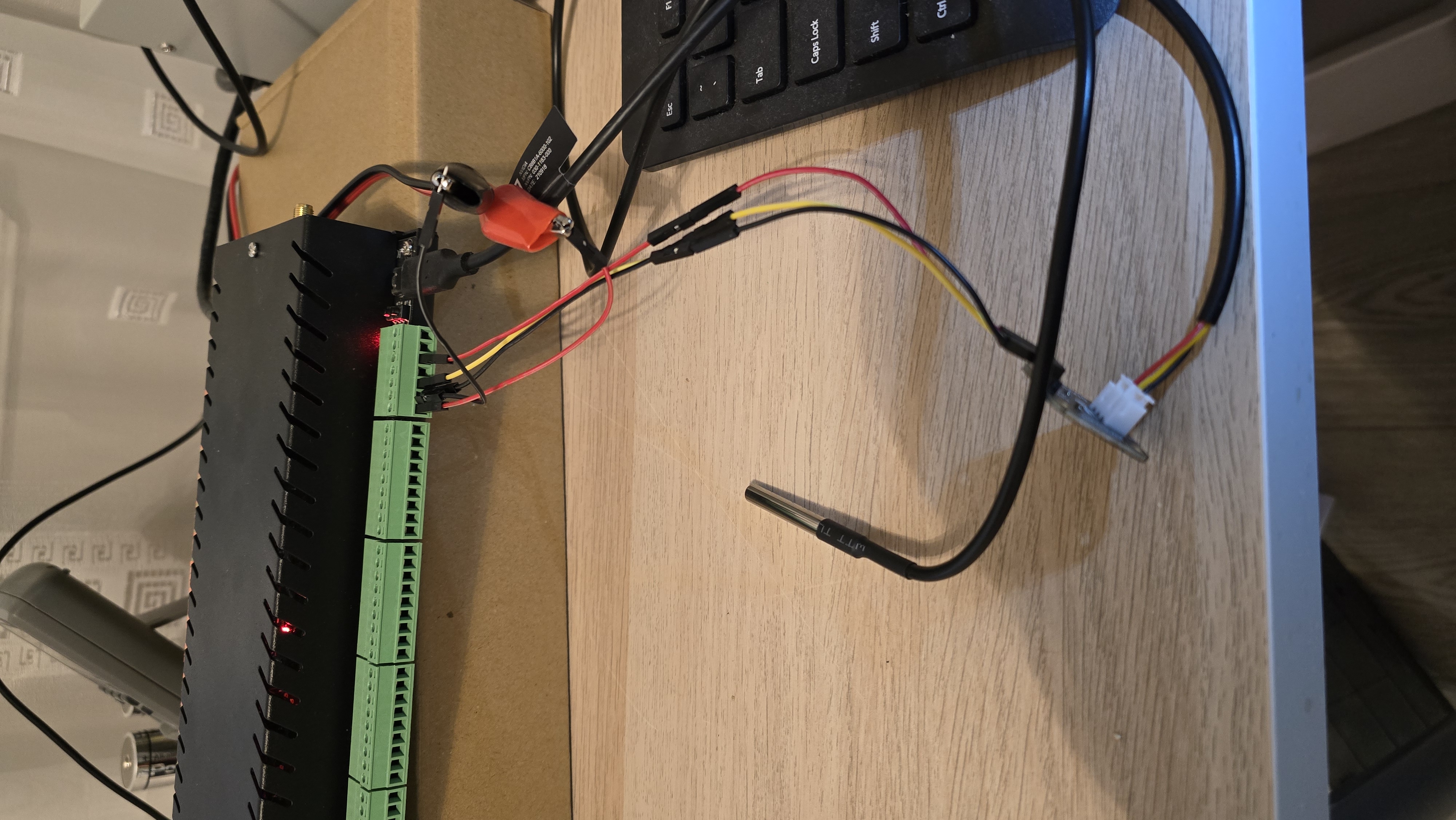

Thanks. It works now with GPIO14.
Posts: 46
Threads: 1
Joined: Dec 2024
I did the same for DHT11 but not showing anything. I connected to same pins with DSS18b20 (only the DHT without the DS).
This is what I used: (Anything wrong?)

So how difficult was for you to just give THESE lines of yaml for the DS18b20 in the first place??
Maybe yaml is easy for you but new users like me struggle to understand what is happening. That means either to drop out your product due to "support issues" and find other product, or struggle for a long time with trial and error.
Posts: 10,582
Threads: 1,591
262
sorry, we can't take all sample demo code. such as you are usuing DS18B20, someone use DHT11, someone use SHT30. The methods of learning and problem-solving are the most important.
