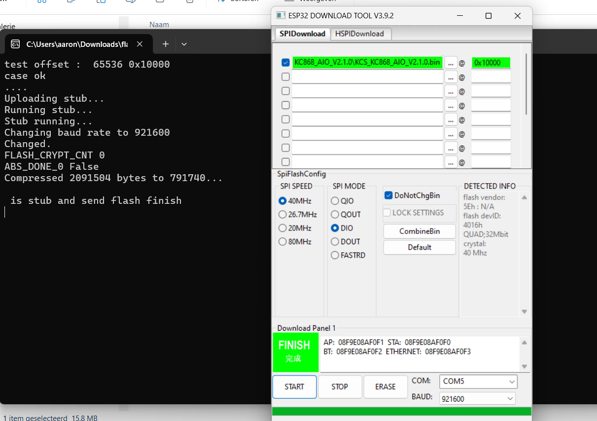

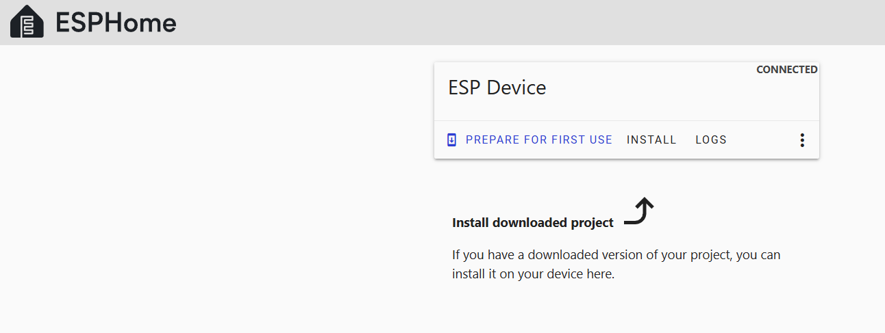

i was able to connect with the download tool so the firmware V2 could be installed but there i get stuck
the download is succesful
but then i can not do anything .
if i use the scan device tool i can not find the kincony
and the wireless signal of the kincony is gone until i re install it with the esphome "install for first use".
i am sure i am making some silly fault but unexperienced me is stuck at the moment Smile
1. the newest KCS firmware is v2.2.2, here is download link:
https://www.kincony.com/forum/showthread.php?tid=3791
2. when you download, your address is wrong, not "0x10000" , it should be"0x0"

i re uploaded V2.2 into my unit on adress 0x0 .

1. after download need re power on of board.
2. KC868-AIO and your PC should connect to same router.
how to use KCS v2, here is online guide: https://www.kincony.com/esp32-kcsv2-firmware.html

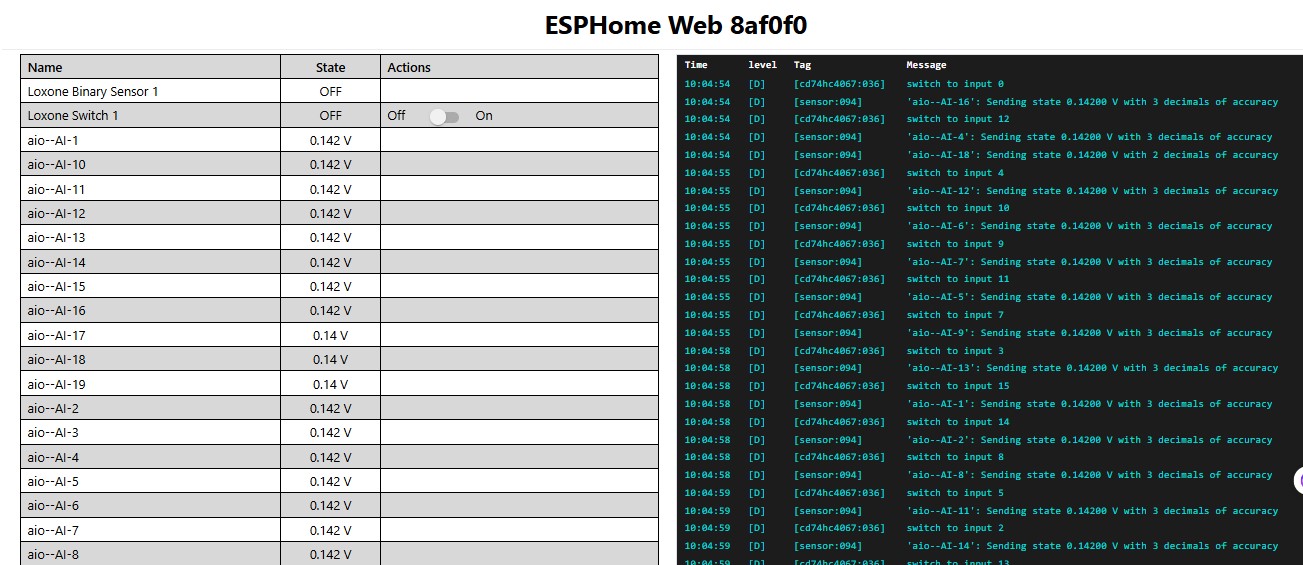

uploaded a new Yaml file to ESPhome with the loxone code writen into it and aletered all inputs and outputs for loxone
i attached the yaml file also

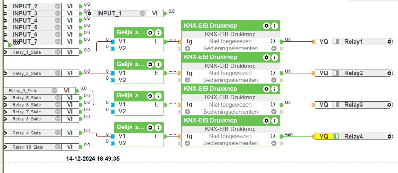

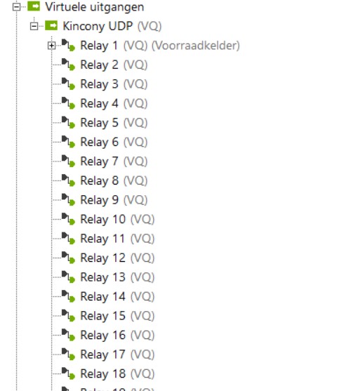

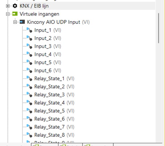

then i did open my loxone config file and imported the UDP inputs and outputs
but i cant get both to communicate with eathother . what am i doing wrong ?

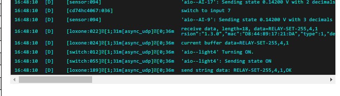

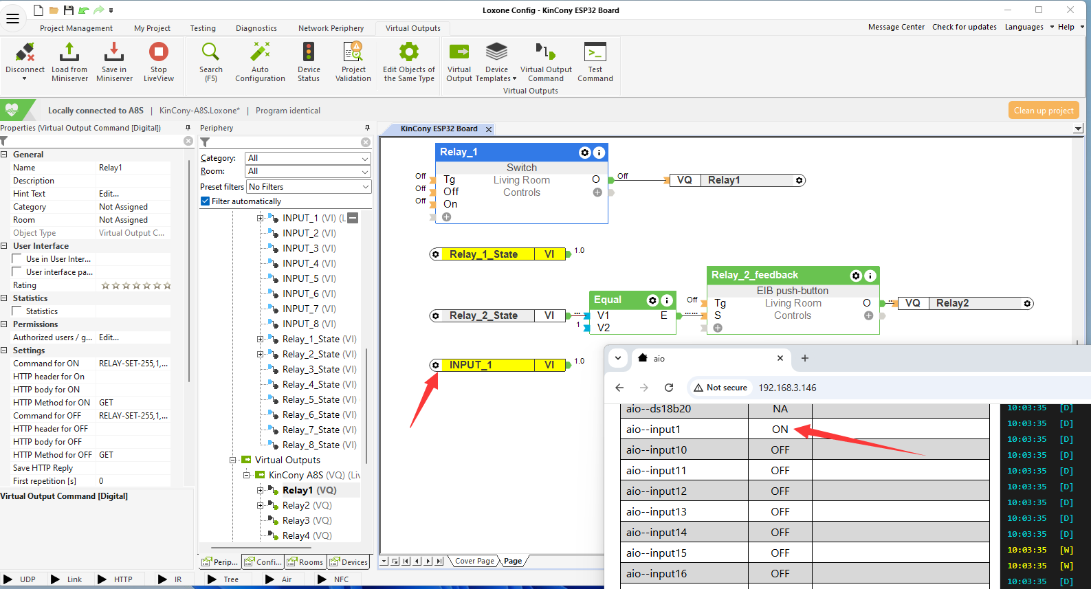

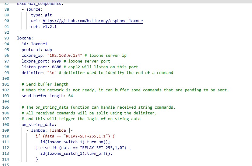

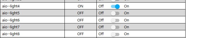

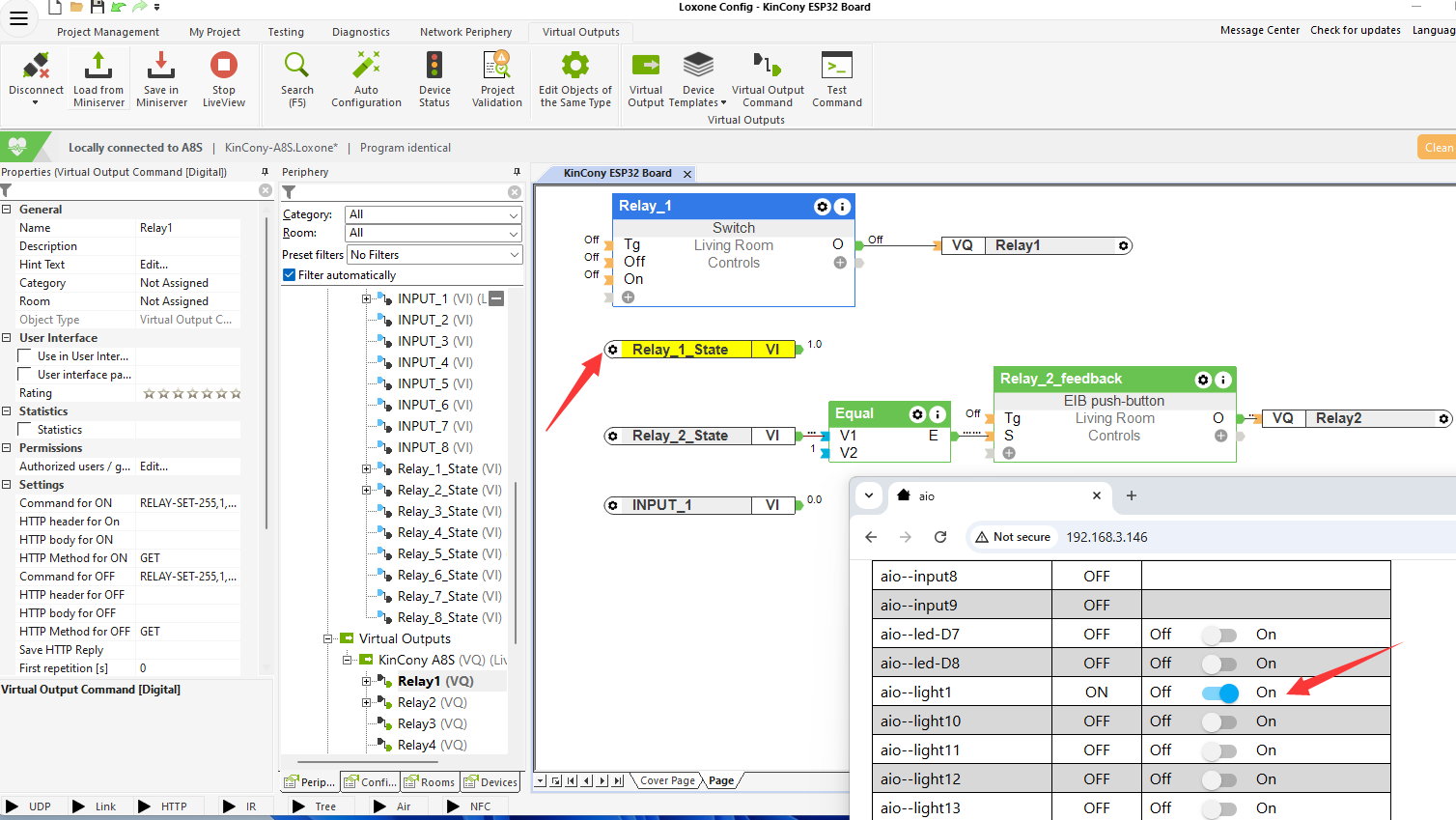

i have tessted KC868-AIO work with Loxone Miniserver, it's OK.
i have write the yaml with 1 channel output and 1 channel input demo for you.  you can enable more channels for Loxone Miniserver.

turn ON output1 by home assistant web page, then Loxone will update:
trigger INPUT1 with GND:
Then will feedback to Loxone config:
Loxone project download:
https://www.kincony.com/forum/attachment.php?aid=3439
Hi ,
thanks for the help ,
i got further but i am running in some new problems:
if i press a virtual button in the loxone app ,
i get this state on esphome :
this is the screen i get at the same time on loxone config :
i think that looks good , but in real life the led of output 4 on the AIO does not turn on . ( i also tested with different outputs but that is the same)
when i press the switch myself in esphome the output does turn on
edit : it seems that i was wrong . the unit freezes when it sends out to the loxone for a state change . it is normaly contanstantly checking the sensor states but when changing one of the relais states and sending it to the loxone it freezes for a little longer than 2 minutes. it also occurs that the lef of the outputs flickers ones for half of a second and then turns off
edit edit : got it solved for the moment ; i changed max output buffer for loxone to 32 instead of 64 and added 100ms delay to all on or off comands for the relais . works like a charm
work well now?
