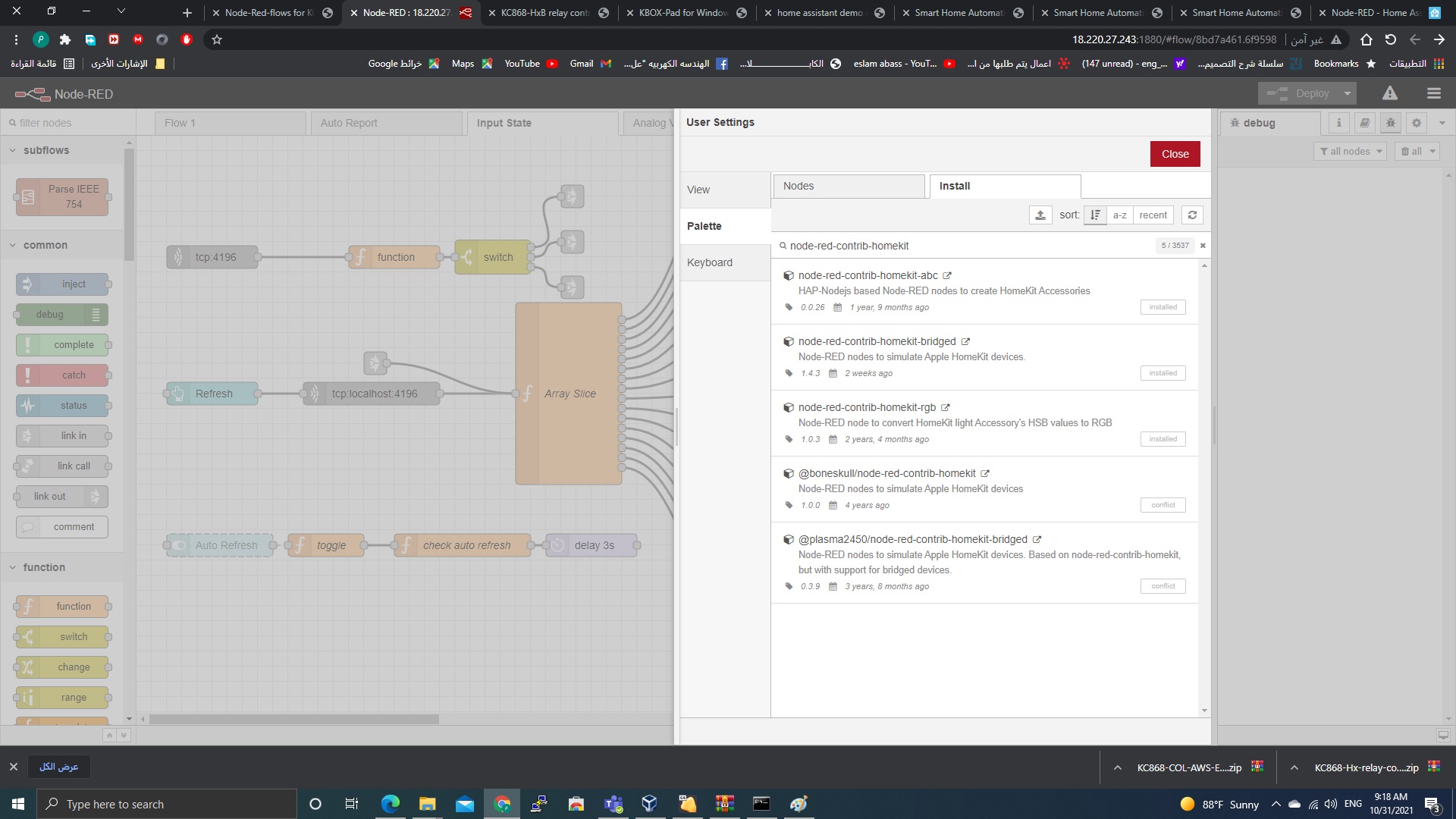

thank you i import flows i install above nodes for node-red but there are error
i have use this node for homekit.
if you not use for homekit, you can delete the node from your follow.
i installed availble node-node-red-contrib-homekit
you can delete the homekit nodes in Node-Red , because it never used, just my last project have used, not delete it .
