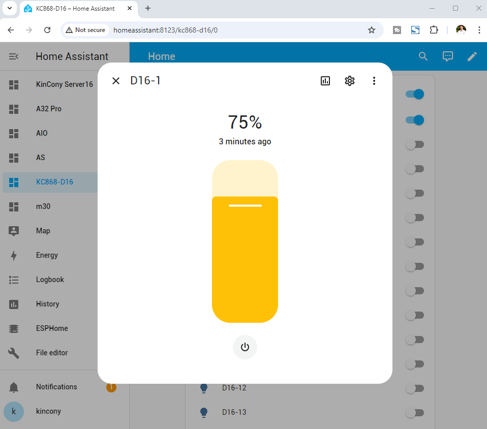

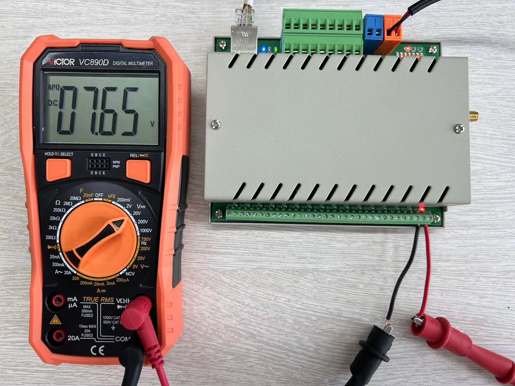

KC868-D16 dimmer controller MQTT configuration for home assistant fixed linear issue
new configuration.yaml file for home assistant MQTT. this file fixed linear issue.
mqtt:
  light:
    - name: D16-1
      unique_id: D16-1
      schema: template
      command_topic: "dimmer/be06d3fd6311b55a970bba37/set"
      state_topic: "dimmer/be06d3fd6311b55a970bba37/state"
      command_on_template: >
        {%- if brightness is defined -%}
        {"dimmer1":{"value":{{ (brightness / 255 * 99) | int }}}
        {%- else -%}
        {"dimmer1":{"value":99}}
        {%- endif -%}
      command_off_template: '{"dimmer1":{"value":0}}'
      state_template: >
        {%- if value_json.dimmer1.value == 0 -%}
          off
        {%- else -%}
          on
        {%- endif -%}
      brightness_template: >
        {%- if value_json.dimmer1.value is defined -%}
        {{ (value_json.dimmer1.value / 99 * 255) | int }}
        {%- else -%}
        {%- endif -%}

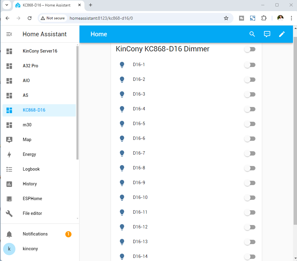

      state_template: >
        {%- if value_json.dimmer16.value == 0 -%}
          off
        {%- else -%}
          on
        {%- endif -%}
        {%- if value_json.dimmer16.value is defined -%}
        {{ (value_json.dimmer16.value / 99 * 255) | int }}
        {%- else -%}
        {%- endif -%}
yaml file download:

Nice! How to know the minimum percentage I can use for turn on a lamp? Some led strips works from %5 on.. , other 220v minimum brightnes start at %25..
What's the exact specification/aspect of the lamp that will determine that?
you can set the "Threshold" in KC868-D16 webpage. for example, some lamp start at 25%, so you can set the "Threshold" =25
[Image: config-setting-Threshold_Setting.png]
Threshold setting: Adjustment startup percent options for every channel output. sometimes LED SSR driver begin work with 10-20% brightness. Different driver have different threshold.
here is online guide of KC868-D16, it have showed: https://www.kincony.com/how-to-use-kc868...oller.html
