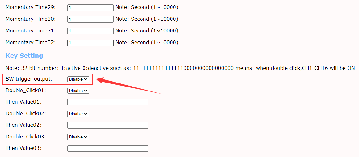

improvement:
add "SW trigger output" option in config webpage.
"SW trigger output" Enable:
32 channel Switch button control 32 channel output.
a. such as key1 press 1 time will trigger output1. key2 press 1 time will trigger output2. key3 press 1 time will trigger output3. ....... until key32 press 1 time will trigger output32.
b. support "double click" define everyone of 32 key's function.
c. ALL ON button: turn ON all (32 channel) output
d. ALL OFF button: turn OFF all (32 channel) output
"SW trigger output" Disable:
a. switch button will not control output directly, but will feedback message by TCP string or by MQTT message.
