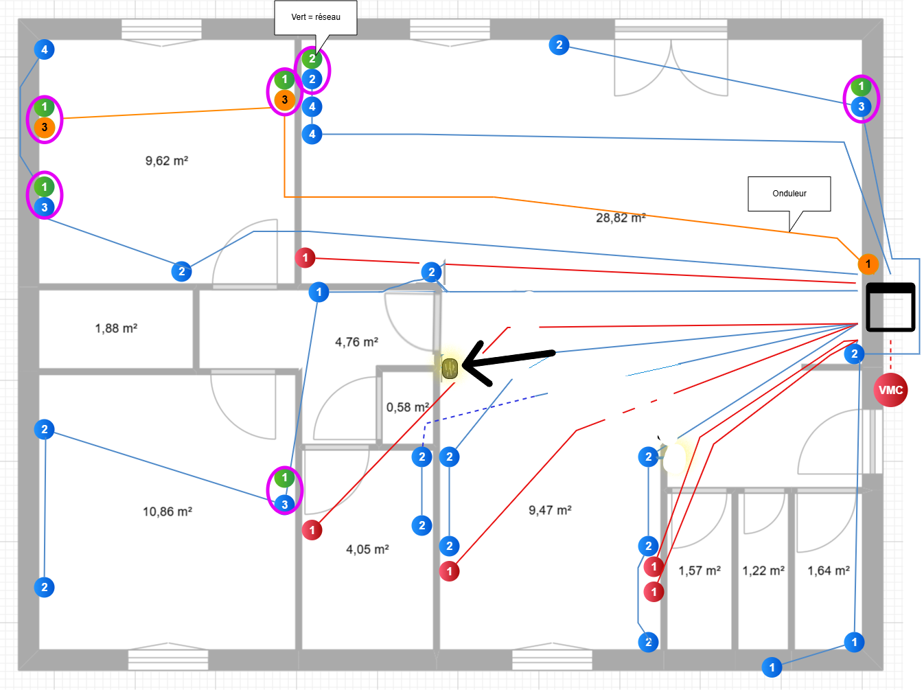

I was planning to get a tablet as soon as possible. I admit I hadn't picked a main spot for it yet, but there aren't exactly endless options. A central location—if I can open up the kitchen—seems perfect (indicated by the big black arrow).
While I'm at it: blue marks standard power outlets; orange marks those connected to a UPS (19" rack and office computer/monitor outlets); red marks dedicated circuits (cooktop, oven, washing machine, etc.); and green marks RJ45 ports. The black box representing my utility room is in the basement.
Oh, and I decided to knock down an entire partition wall just today, so who knows what might change before the major work begins.
I started ordering my electrical gear today. I'm going with a 4x18-module unit for the main electrics and an 800x600x300 enclosure for the home automation system. The price-to-quality ratio is actually pretty good.
Blue marks standard power outlets; orange marks those connected to a UPS (19" rack and office computer/monitor outlets); red marks dedicated circuits (cooktop, oven, washing machine, etc.); and green marks RJ45 ports. The black box representing my utility room is in the basement.

My VMC has an RJ45 port, useful to integrate it in Home Assistant. I don't see one on the plan, it could be good to include it just in case.
Also I didn't plan a higher-up RJ45 port in any room, and it turned out that wifi coverage is way better if the access point is above the furniture and other obstacles. After the construction was done, I had to replace an electrical socket with an RJ45 above the kitchen furniture. This allowed to replace three access points with a single one.

Oh, that’s interesting!
I have some RJ45 lines in the attic that aren't shown on the socket diagram: two for outdoor camera locations, one for a ceiling-mounted Wi-Fi access point, and potentially one for a PoE Zigbee/Thread dongle and/or the RTS module for the shutters. That network cabling is going to get used up fast. In any case, I’ve planned for two empty conduits (keeping 230V separate from the network cabling).
As for the ventilation system (VMC), I’d happily run an extra network cable; however, since I’ve planned for a basic "Hygro B" system with very simple operation, a manual override switch at the distribution board—likely a global one rather than individual vent control—that I could program via certain light switches seems sufficient. I haven't really planned anything elaborate for that part.
