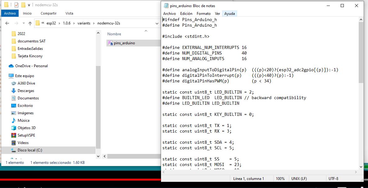

That's right, I modified
Image(s)

(05-07-2022, 03:24 AM) Hector_Lozano Wrote: (05-07-2022, 02:56 AM) Hector_Lozano Wrote: I think so,
I'm using for outputs.
PCF8574 pcf8574_S(0x24);
you should set the A8 to MQTT mode i think now your code is use TCP mode
