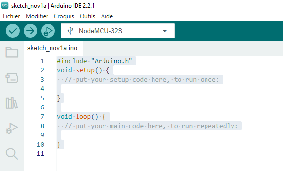

I tried the demo code for A64 you recommande, but it doesn't work. After transfering code, the A64 doesn't work (impossible to connect on his IP adress, light of ethernet connection off).
So, I  try to use a very simple code, as below, but it doesn't work too, the A64 stopped,; I need to download firmaware again. I used as you recommande board NODEMCA-32S.

#include "Arduino.h"
void setup() {
  // put your setup code here, to run once:
void loop() {
  // put your main code here, to run repeatedly:

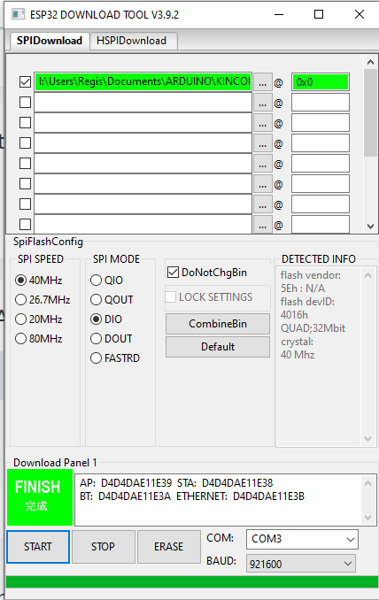

how you download firmware of KCS? can you take a screen photo of setting, upload at here.
(11-01-2023, 10:34 PM)admin Wrote: how you download firmware of KCS? can you take a screen photo of setting, upload at here.
Attached the screen shots + the screen shot with TUYA that correctly work .
I tried also to download with the adress 0x010000 (seen on one of yours documents), but also doesn't work
download KCS firmware, address is 0x0
if can't download. lower your COM port Baud rate.
