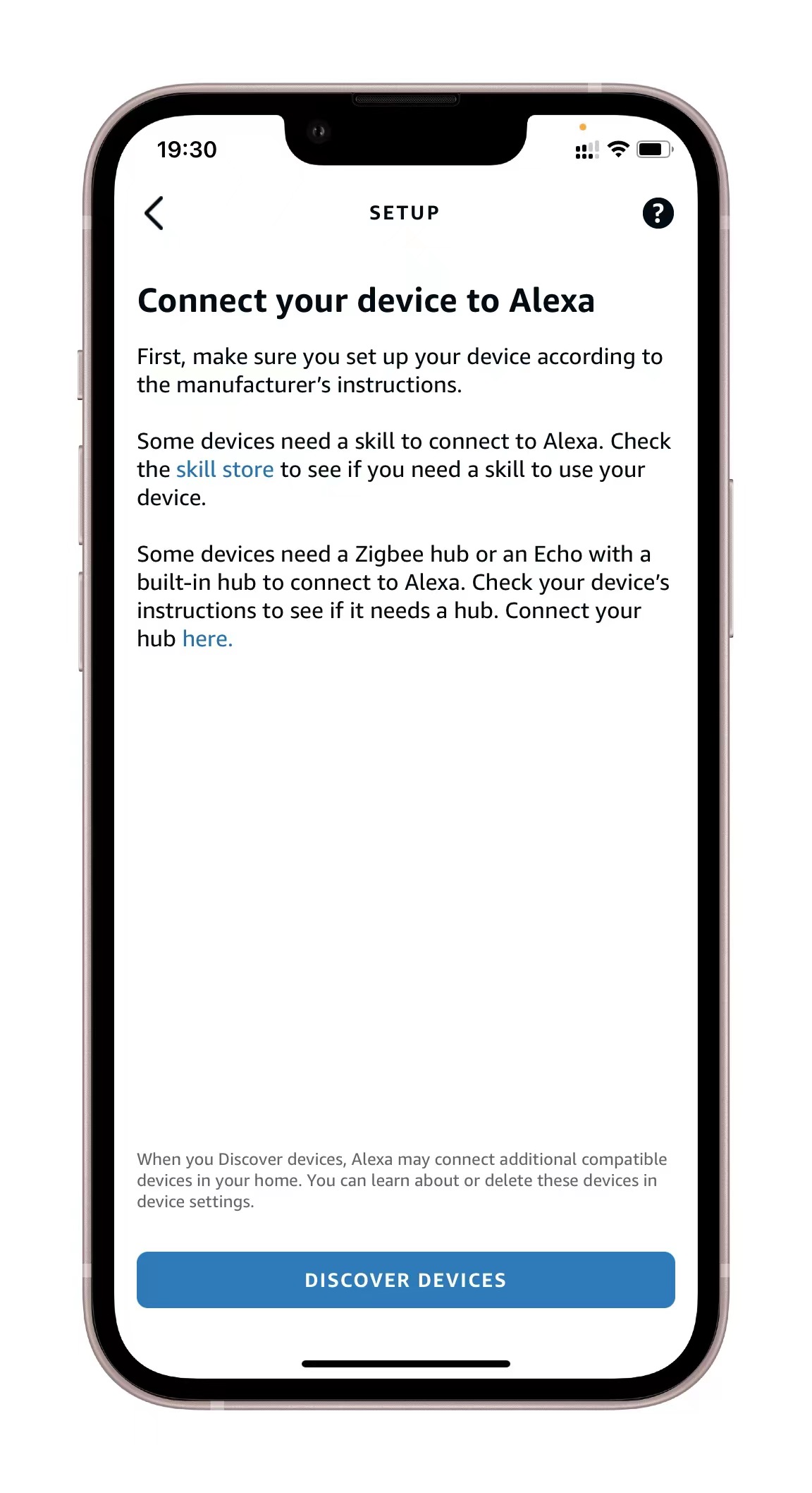

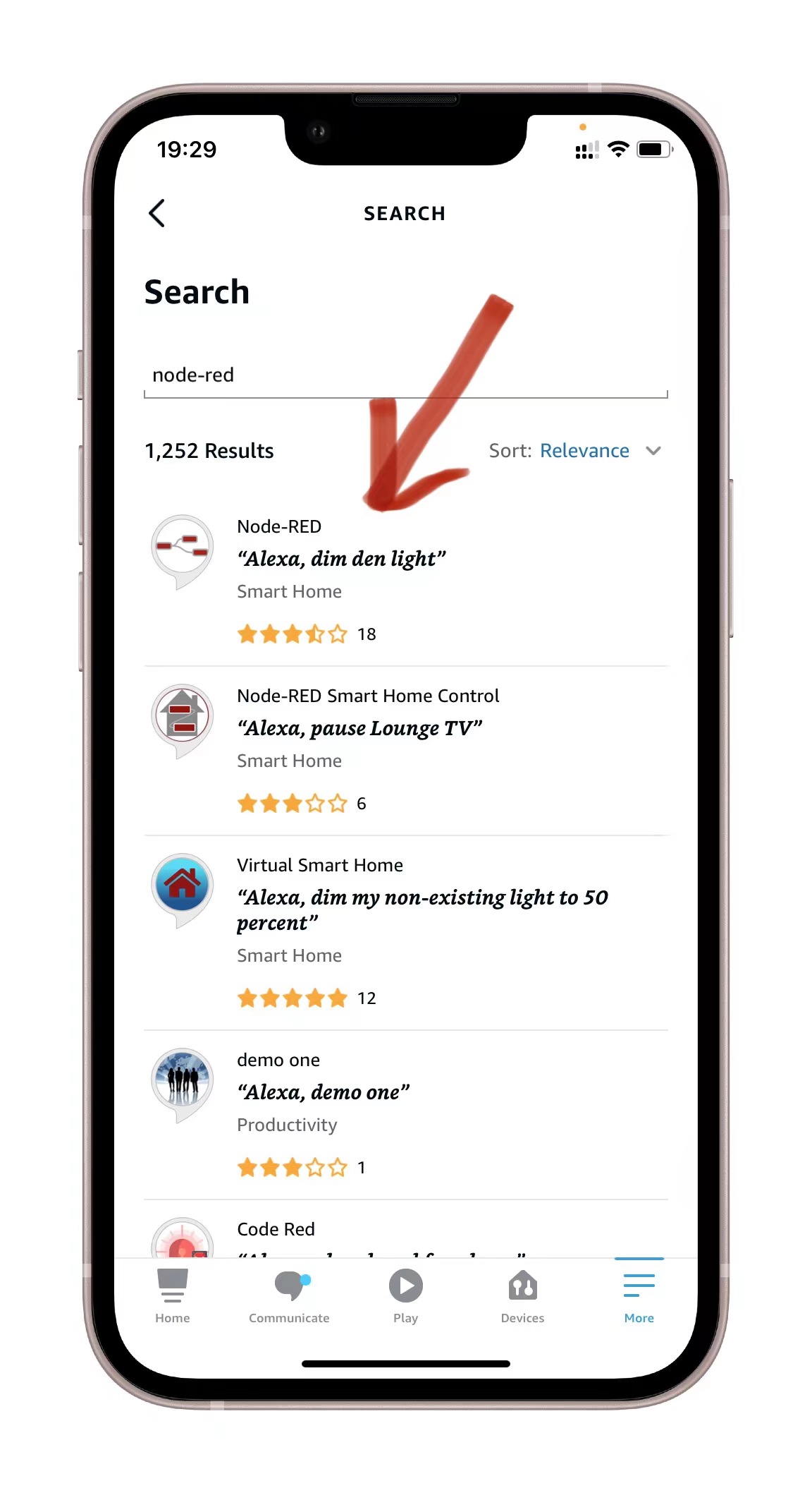

6. add skill (Node-Red) on Alexa phone app
7. Discovery for new device

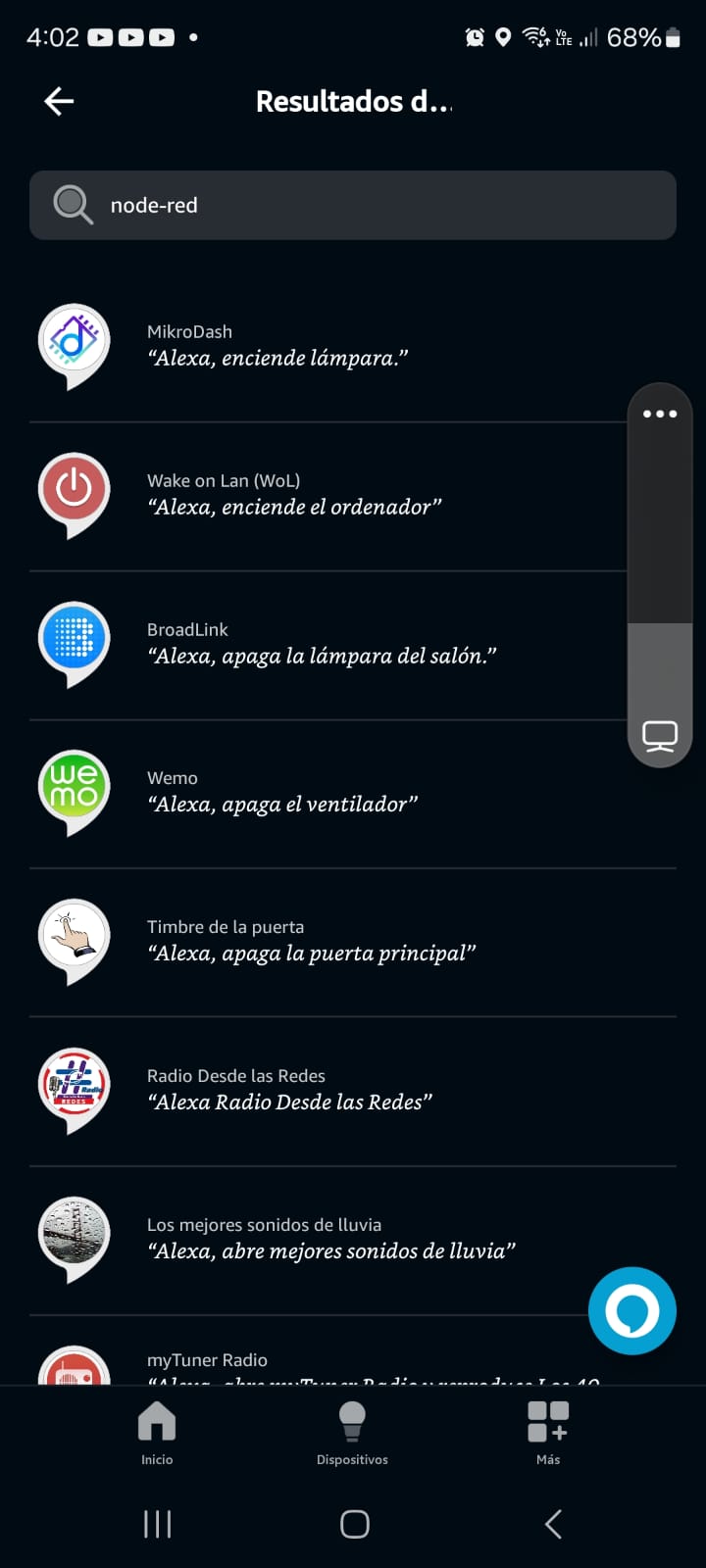

No present de Node-Red in Skill Alexa
